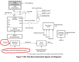

Other related questions:
  1. On Figure 7-158 of TRM, which SYSCLK is EPWMCLK derived from?   See Figure 6-24
    • R5SS_SYS_CLK or SYS_CLK_GATED.
  2. On Figure 7-158, where can I find the register "ClkCfgRegs.PERCLKDIVSEL[EPWMCLKDIV]" to configure the EPWMCLK Presacle?
    • None of the tokens/words can be found from searching SDK code and Register Addendum.pdf
Providing some pictures for my question to help.

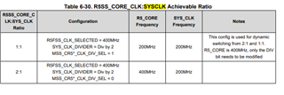

  • Hi Huey
    SYSCLK can't be greater than 200MHz as the DESIGN is timing closed for frequencies upto 200MHz.
    The above excerpt is from the TRM and shows the only supported frequencies and ratios of R5CLK and SYSCLK
    Akshit
