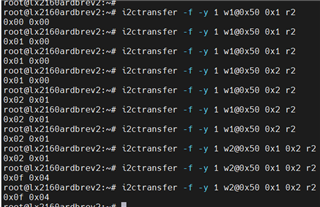

Dear Ti teams,
I want to get some info from MSPM0G1505 through I2C.
Now I can successfully get the response from MSPM0G1505, but it seems I got the last time TX buffer.
For example, I send 0x1, I want to receive 0x1, but I receive 0x00 the first time, unless I send 0x1 again, then I receive 0x1.
Then, I send 0x2, I hope to receive 0x2 0x1 the first time, but I still receive 0x1, unless I send it again.
The same issue occurs when sending 0x1 0x2, it seems I always get the TX buffer from the last time. I want to know why and how to optimize my code.
I have uploaded the logs and some key parts of the code. Could you help to review if there are any issues?

  • some additional info
    As shown in the code, when I send 0x3 to MSPM0G1505 the first time, although I get the last time buffer[wrong buffer, not 0x6], I observed that the voltage was actually changed in fact.
    So I guess it might just be that the TX buffer seems to be delayed for some unknown reason.

  • This logic appears to require a Stop between the write and the read, in order to turn the buffer around. As I read the i2ctransfer(8) man page, all of the "messages" on the command line are sent in one "transfer" (transaction), which uses Repeated-Start (no Stop-s) between messages.
    Is there a way you can fit your Stop logic into the Start case? Alternatively, try sending one message per i2ctransfer run.
  • Hi Bruce,
    Thanks for the idea you provided. I used i2cget/set to separately write and write, and it seems to work. I will write another app to do write and read with an internal stop.
    But I noticed the TXFIFO buffer was not cleared after the last time sending.
    the first read, i get 0x0000, because there is no data in TXFIFO, it`s okay
    the second read, i get 0x040f, since i write 0x01 0x02 to RX, it`s also should be fine.
    but for the thrid read, i still get 0x040f, It seems the TXFIFO was`t cleared successfully.
    I think this should be like a queue, but it seems the DL_I2C_flushTargetTXFIFO function didn't clean the TXFIFO successfully. Do you have any comments about this issue?

  • Though it doesn't say explicitly, it appears i2cget(8) is designed to read a "register", which implies it performs the sequence (a) write one byte (b) repeated-Start [no Stop] (c) read one {byte or word} (d) Stop.
    This is a variant of your earlier problem. Since the Stop is only happening after the read, the next i2cget repeats the 0x01 request, and the 0x02 is still left in the gRxPacket, so it gives back the same result -- it's not left over in the FIFO, your code puts it there again.
    To make sure you know what you're sending/receiving, I suggest you go back to i2ctransfer and limit yourself to one "message" per "transfer". [I'm using quotes since that isn't the terminology used in the I2C spec.]

  • Hi Bruce,
    I wrote a simple C app to write and read through I2C. It seems that separating the operations indeed works, and I can read the values I need each time.
    Regarding the "stale" TXFIFO data, I think this functionality is not necessary in my scenario.
