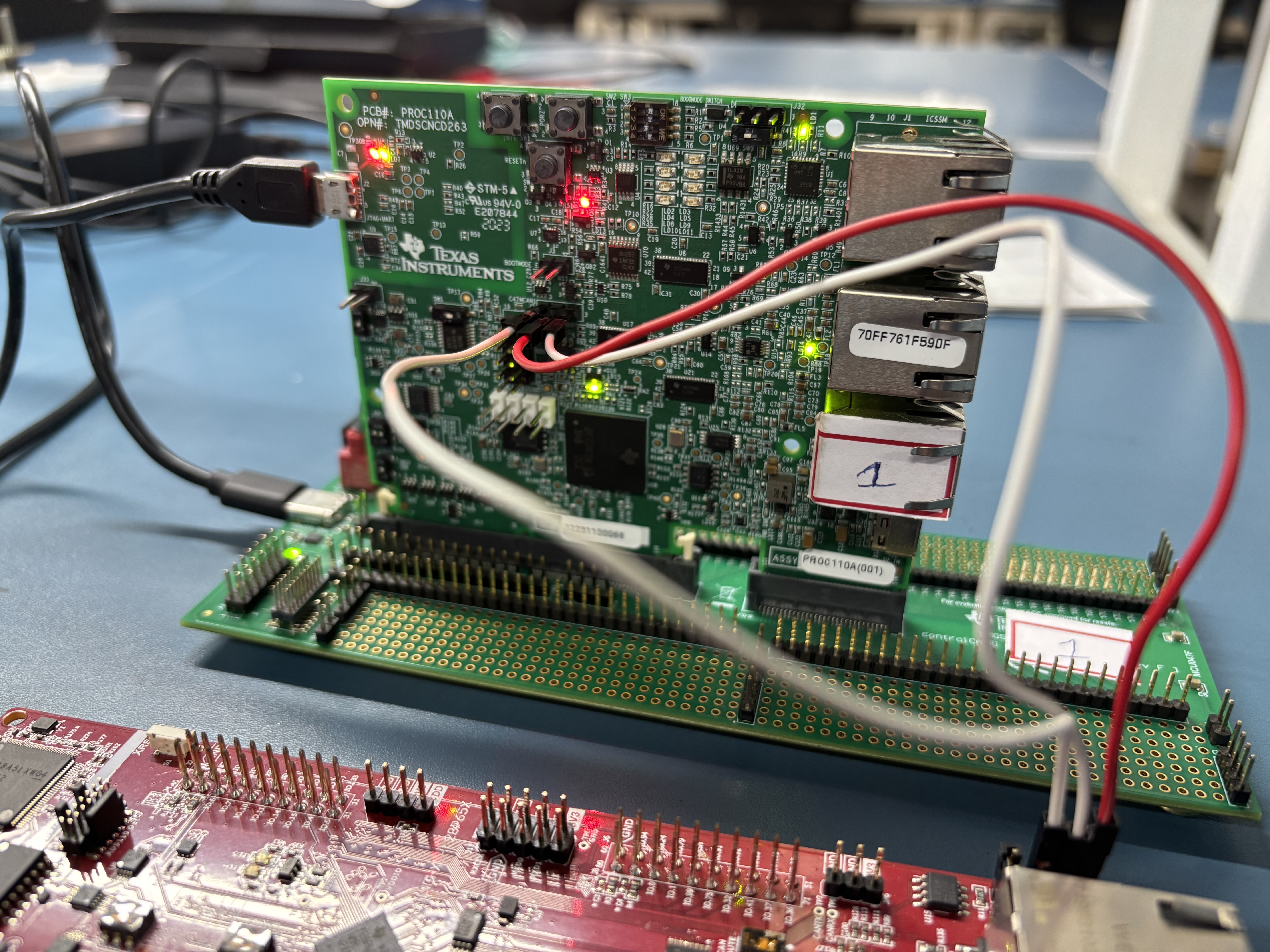

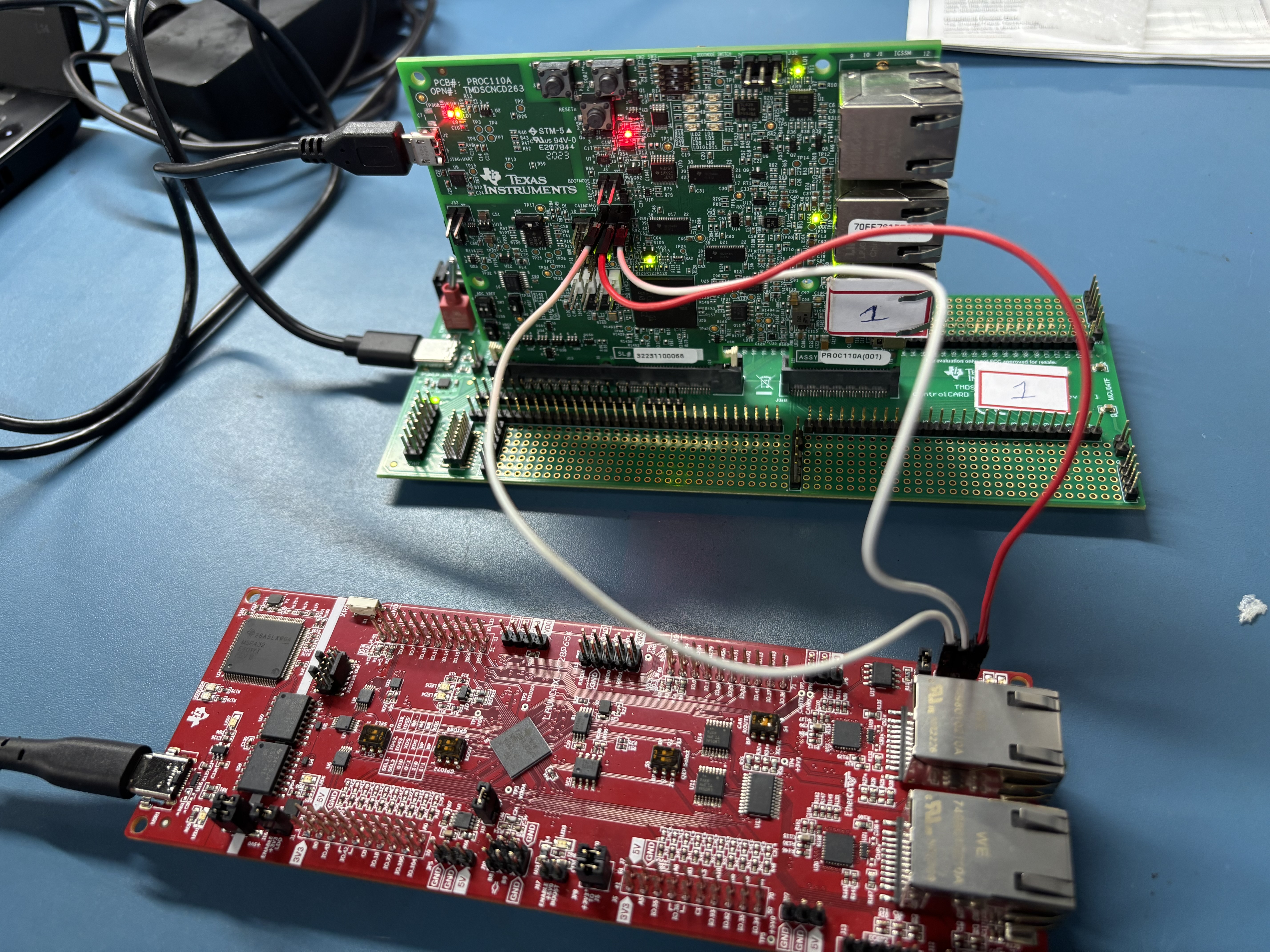

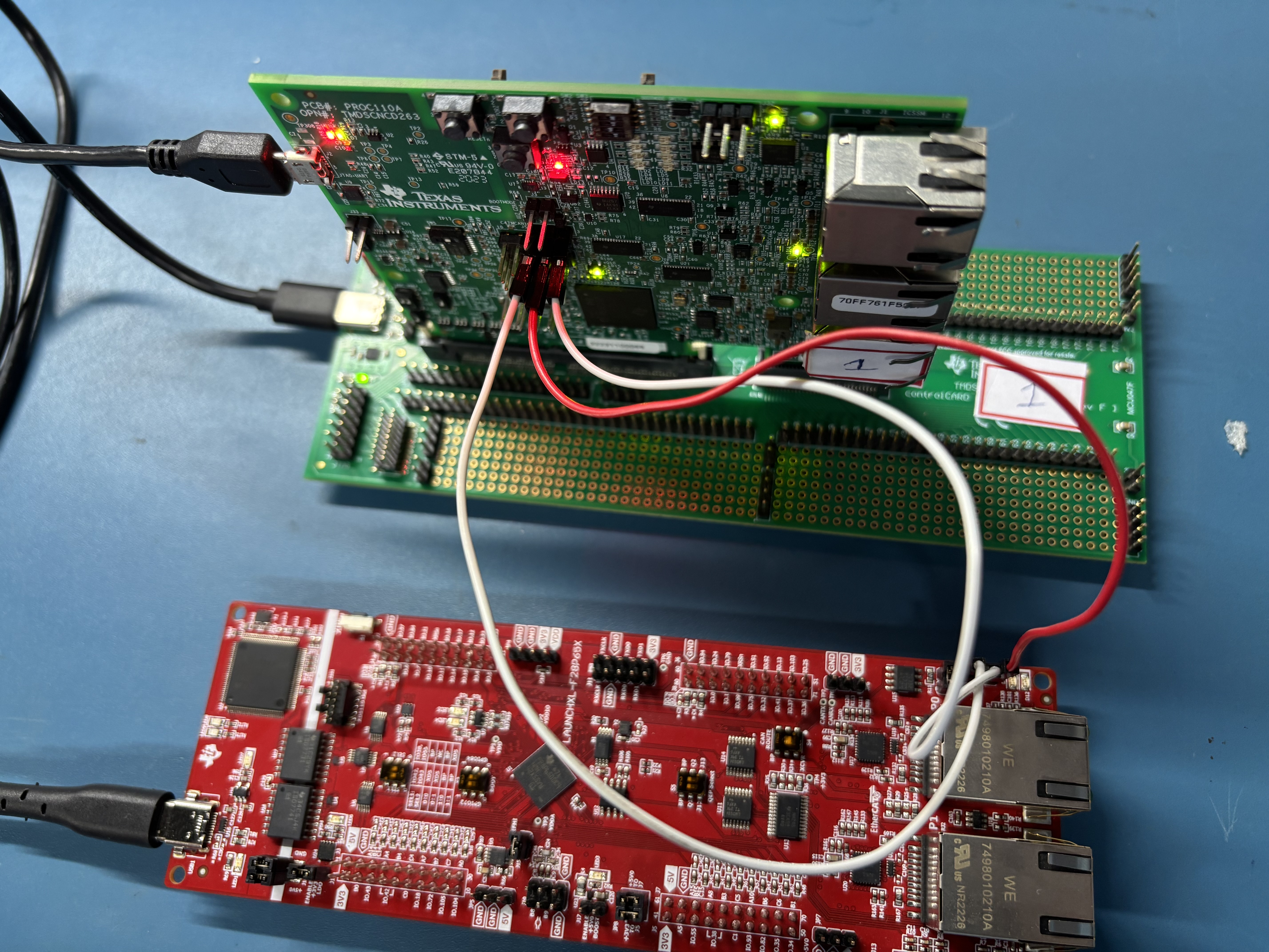

We are experiencing issues connecting the AM2634 board with the LaunchXL-F28P65X via CAN. We are unable to transmit data successfully over CAN. What configurations should we check on both boards to enable CAN communication? Are there any other factors we should consider?

  • Hi Ralph
    We have externally connected the CAN ports, with MCAN1 on the AM263X (MCAN1_CAN_H, MCAN1_CAN_L, GND) routed through J5 and CAN_HI, CAN_LO, and GND on the F28P65X connected via J14.
    Internally, in the SysConfig file:
    • On the AM263X, MCAN1_RX and MCAN1_TX have been enabled.
    • On the F28P65X, GPIO4 and GPIO5 have been configured for CAN communication.

  • Hi Ralph
    We are using AM263X_CC, not LP-AM263. The MCAN1 interface on the AM263X_CC is connected via MCAN1_CAN_H, MCAN1_CAN_L, and GND, routed through J5.
    We tested the CAN loopback mode on both boards, and it is working correctly. However, when connecting the two boards for CAN communication, we are unable to transmit data.
    While attempting to send data from AM263X_CC to F28P65X, we encountered the interrupt MCAN_INTR_SRC_PROTOCOL_ERR_DATA, and the transmission is failing due to the condition can_bus->tx_done != true not being met.
    Could please help on debugging it.

    Ralph Jacobi
  • Hi Ralph
    We have tested MCAN communication on both AM263X_CC and F28P65X boards separately and confirmed that they are functioning correctly. Specifically:
    1. AM263X_CC Board:
      • We connected two AM263X_CC boards via their MCAN interfaces and verified that communication is working as expected.
      • Additionally, internal loopback mode was tested and found to be functioning properly.
    2. F28P65X Board:
      • Similarly, we connected two F28P65X boards via their MCAN interfaces and confirmed that MCAN communication is successful.
      • Internal loopback mode was also tested on these boards and is working correctly.
    3. MCAN Transceiver Status:
      • The MCAN transceiver is enabled on both the AM263X_CC and F28P65X boards.
      • Communication within the same board using loopback mode, as well as communication between two identical boards, is working properly.
    Issue:
    • When attempting to establish MCAN communication between an AM263X_CC board and an F28P65X board, communication fails.
    • The connection is established as follows:
      • AM263X_CC: MCAN1 signals (MCAN1_CAN_H, MCAN1_CAN_L, and GND) are routed through J5.
      • F28P65X: MCAN signals (CAN_HI, CAN_LO, and GND) are connected via J14.
    • Despite using the correct wiring configuration, the two boards are unable to communicate over the MCAN interface.
  • Hi Anjana,
    Thanks for sharing these details which confirms no hardware configuration issues between the boards. Those are the most common issue with these boards particularly due to the MUX involvement on the AM26x side. With that, I'm going to loop in our CAN expert who can help better with next steps.
    Initial thoughts on my end include making sure CAN data rates and other protocol related settings are correct. Also confirming both devices are working as CAN-FD (I would expect yes but sanity check maybe).
    Ralph Jacobi
  • Hi Ralph
    We are working with CAN-FD, and we have confirmed that the CAN data rates and other protocol-related settings are correctly configured from our end.
    Could you share an update on the status of our issue? We would appreciate any new insights or progress updates
  • Hi Anjana,
    I have reviewed the information provided up until this point.
    Is it possible to probe the CAN_H/CAN_L and CAN_RX/CAN_TX lines to verify proper signal chain from CAN Bus to CAN Transceiver to MCU.
    When you say communication fails, what does this actually entail? What is the exact failure signature?
    Zackary Fleenor
  • Can you also confirm the setting of the S4 (CAN ROUTE) switch on the F28P65x launchpad? Looks like this is set to 1 by default which routes the CAN TX/RX signals to the boosterpack instead of the CAN Transceiver (U15) which is connected to the J14 header.
    -Zackary Fleenor
  • Hi Fleenor,
    As previously mentioned, MCAN communication within the same board, using loopback mode, is functioning correctly. Additionally, communication between two identical boards is also working as expected.
    However, when attempting to establish MCAN communication between an AM263X_CC board and an F28P65X board, the communication fails. We are encountering the MCAN_INTR_SRC_PROTOCOL_ERR_DATA interrupt, and transmission is failing due to the condition:
    can_bus->tx_done!=true
    not being met.
    Furthermore, even after setting the S4 (CAN ROUTE) switch to 0, the issue persists.
    We need guidance on how to proceed further in troubleshooting and resolving this issue. Could you provide insights into potential causes and debugging steps?
    Which device first encounters the failure?
    Can you probe the CAN_H/CAN_L lines and provide screenshots? We need to see exactly what the signal between the two devices looks like.
    Can you also probe the CAN_TX/CAN_RX lines of the failing device?
    I am also working to get a setup going in parallel to attempt to replicate the issue. Can you share the project files being used for both devices for additional debug?
    Zackary Fleenor
  • Hi Fleenor,
    I have probed the CAN_H and CAN_L lines for all the scenarios and documented the results in the attached PDF file. The screenshots included in the PDF capture the signal waveforms and any anomalies observed during communication.
    The scenarios covered in the PDF are as follows:
    1. F28P65X to F28P65X Communication:
      • The behavior of the CAN signals when two F28P65X devices are connected.
    2. AM2634 to AM2634 Communication:
      • The behavior of the CAN signals when two AM2634 devices are connected.
    3. F28P65X to AM2634 Communication:
      • F28P65X transmitting to AM2634:
        • The F28P65X repeatedly attempts to transmit data to the AM2634.
        • The same transmission process is retried multiple times until it eventually times out and fails.
      • AM2634 transmitting to F28P65X:
        • When the AM2634 sends data to the F28P65X, it encounters a MCAN_INTR_SRC_PROTOCOL_ERR_DATA error, indicating a protocol issue during data transmission.
    Please review the PDF document containing the screenshots of these waveforms and let us know how we should proceed further with debugging and resolving the issue.

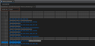

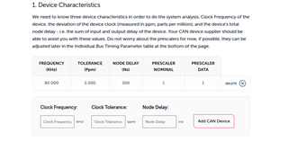

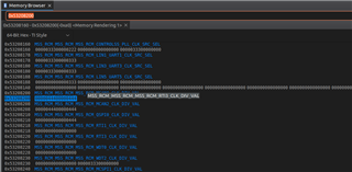

  • Hey Anjana,
    In the table you provided for the CAN Timing Parameters, where did the values of AM2634-80MHz and F28P65x-100MHz values come from?
    Have you used the CAN Bit Timing Calculator to validate these values?
    Zackary Fleenor
  • Hi Fleenor
    For AM2634, in the TRM in the table 13-262, it is mentioned as DPLL_CORE_HSDIV0_CLKOUT0 is of 400 MHz. The default MCANn divider is 5. So, the MCAN CLK is 400 MHz/5 = 80 MHz.

    Can you confirm the values of the following registers during runtime:
    MSS_RCM_MSS_MCAN0_CLK_SRC_SEL Register (5320 8100h)
    MSS_RCM_MSS_MCAN0_CLK_DIV_VAL Register (5320 8200h)
    This will provide us with the true clocking values.

  • Hi Fleenor
    Apologies for the delayed response.
    We have checked for the values of the following registers, which we read from the memory browser:
    • MSS_RCM_MSS_MCAN0_CLK_SRC_SEL
    • MSS_RCM_MSS_MCAN0_CLK_DIV_VAL
    Additionally, we are in parallel using a CAN Bit Timing Calculator to verify and fine-tune the timing parameters in order to establish reliable communication between the two boards.
    Also, we tried with the above frequency for the Bit timing calculator and checked, we are not being able to do the communication and getting the same error as previously.
    Could you please assist us in reviewing these values and guide us if there’s anything we might have missed?
