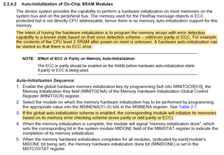

  • Hi Gobind Singh,
    It is not controller problem,
    My understanding is that we should never access the RAM memory without calling _memInit_ function. This is because,
    to understand it refer below highlighted sentences in the TRM:
    So, without hardware initializations your RAM will be full of single and double bit ECC errors. Just like as mentioned in below thread:
    (15) Compiler/TMS570LS1227: Retention RAM data after software reset. - Arm-based microcontrollers forum - Arm-based microcontrollers - TI E2E support forums
    So, if you are trying to access these corrupted RAM then it will automatically perform single bit error corrects (that means your written data might get changed), that means if you try to compare the data then the data mismatch will happen, and RAM testing's will get fail.
    So, it is always good to do RAM testing's after doing _memInit_.
    Thanks & regards,
    Jagadish.
