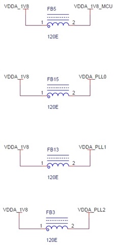

In the AM243x EVM Schematic, some 1.8V analog supplies are distributed through some FBs, but the customer want to reduce the number of FBs.
Is it possible ?
For example, is it no problem if they design VDDA_PLL0, VDDA_PLL1, and VDDA_PLL2 using one FB ?
Or they should use each FB for each supply ?
Could you tell them the reason why ?
