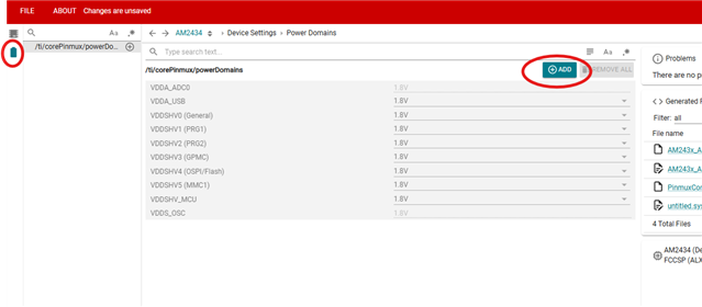

Another question, why can't "Preferred Voltage"  be configured?
  • Which version of SysConfig are you using?
    I checked the online version (1.23.0+4000) at https://dev.ti.com) and see the following pins  for ALV.  The ALX package has the same signals.
    You can enable the preferred voltage by adding the voltage domains via the "Device Settings" tab - battery symbol at top left.. then clicking the "ADD' button. You can then select the voltages for each domain
    --Paul

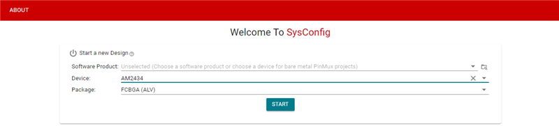

  • Hi Paul, why doesn't my local SysConfig tool have "Device Settings" option.
    Device setting option is available with the pinmux tool and is not available if any software product is selected.
    Leave the software product empty as shown below. Select the device and start the tool.

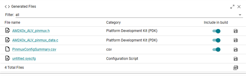

  • Thanks Tushar! I'm a little confused, if I design a new board and want to use the INDUSTRIAL COM SDK, can I still use SysConfig tool and how do I get started? How to generate my own bsp?
    If you want to generate the pinmux file for all the pin configuration then use the pinmux tool as shown above.
    The above will generate pinmux config files. Please refer below image.
    For SDK, with every example there is an example.syscfg file which you can modify according to the usecase.
    Please refer SYSCONFIG_INTRO for details.
    Tushar

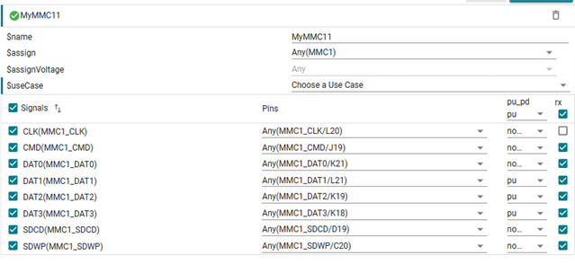

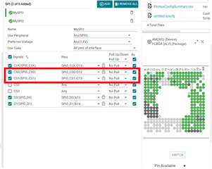

  • Some configuration options can't be found in SysConfig->Software, eg MMC->MMC1.SDWP, SOC_SPI->SPI0_CS1, SOC_SPI->SPI1_CS1, UART->UART0_RTS, UART->UART1_RTS and so on.
  • Hi
    The pins which are not present via Sysconfig are either not supported or not needed. Please refer TRM & Datasheet for details.
    This pins are available under Chip select section for McSPI.
    If you still want to configure this pins, please refer method suggested here.
    Tushar
  • Thanks Tushar! options in red box can't be found in SysConfig->Software.
    You can use the Pinmux tool to configure such pins as described in earlier replies.
    Tushar
