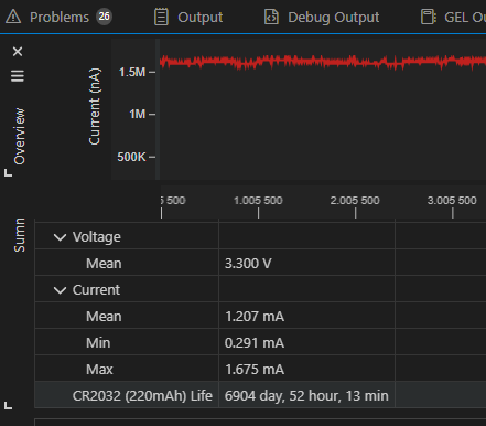

CR2032 can source 220 ma for 1 hour. if mean current is 1.207mA then CR2032 can power the circuit for 220maH/1.207 == 182.27 hours == 7.59 days. Not 6904 day as calculated by your tool. This is a bug.
Hi Chris,
This is a known issue that was fixed in CCS 20.1.0:
https://sir.ext.ti.com/jira/browse/EXT_EP-12165
