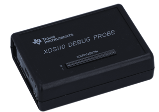

  • Hi Cash,
    Today, I loaded an MCU program and checked it, and the ceramic resonator output was about 8 MHz.
    The voltage was only just under 400 mV.
    I checked the MCU standards but did not understand the required specifications.
    Currently, when I re-boot by resetting after programming the MCU, an error occurs where the XDS110 probe cannot connect to the target,
    and I think this is caused by the output level of the ceramic resonator.
    I would appreciate some advice.
    I'm in a hurry.
    Best regards;
    Hiroshi Yamada

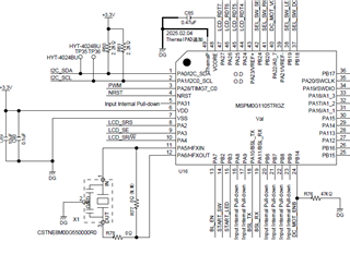

    The voltage 400mV seems low. Do you have any load caps around the HFXT in the circuit. If so, try remove those caps, since the built in load capacitance is high enough.
    Cash Hao

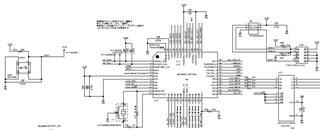

  • Hi Cash,
    Thank you for your quick comment.
    Is it really low?
    The current circuit diagram is as shown below, and there is no load.
    R77 is non-mount.
    How many volts do I need?
    I can't connect the XDS110 probe, so I can't switch the internal oscillator.
    Best regards;
    Hiroshi Yamada
    To reconnect with MCU. You can try hold the NRST pin to low before power up the MCU. Hold it then power up the MCU. Then try to connect with XDS-110 and check if you can program the MCU or run a factory reset.
    For the crystal, I think the voltage should close to VDD.
    Maybe you can try with R77 as 1Mohm and R78 as 330ohm, just like the one suggested in the crystal datasheet.
    Cash Hao

  • Hi Cash,
    I have a question.
    Does this mean that the NRST pin of only the MCU is held low?
    Currently, NRST is also connected to the connector for connecting the XDS110 probe.
    Does this mean that if it is only the MCU's NRSRT, work is required to separate it?
    You said to turn on the MCU's power while holding the MCU's NRST low, but can I release the low NRST after turning on the power?
    NRST is also connected to the XDS110 probe, but if I turn on the MCU's power while holding it low, and then release NRST and try to connect the XDS110 probe, I cannot connect. (Target not connect)
    Please let me know about your previous inquiry as well.
    Best regards;
    Hiroshi Yamada

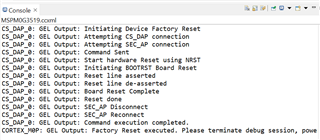

    You can disconnect the NRST pin to the XDS110 before powering up the MCU. After power up the MCU, you can release the NRST pin to HIGH.
    For factory reset process, please refer to this guide.
    3542.Factory_reset_v3.pdf
    Cash Hao

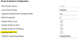

    What does this mean?
    Is it the following part of Sysconfig?
    Or is it a setting on the XDS110 probe side?
    Please help.
    Hiroshi Yamada
    No, it is not a configuration in sysconfig.
    You can disconnect the NRST pin to the XDS110 before powering up the MCU manually on the hardware side.
    After power up the MCU, you can release the NRST pin to HIGH by reconnecting the NRST pin to the XDS110 RST pin.

    It is not the thing written in the XD110 probe user's guide. Use LP for example, before power up the MCU, I remove the jumper on the NRST pin. It disconnect the conection between MCU and XDS-110 on the NRST pin. Then I manually connect the NRST pin to GND. And then power the board.
    After power up the board, you can connect NRST back to the XDS-110 NRST pin.
    Cash Hao

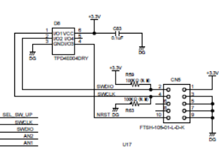

  • Hi Cash,
    Thank you for your comment.
    I may be misinterpreting this, but I previously attached a circuit diagram which has a switch (tactile switch) that manually sets NRST to low.
    BThis switch is connected to NRST of CN5, which connects to the MCU and the 10-pin adapter of the XDS110 probe.
    Best regards;
    Hiroshi Yamada

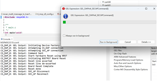

    The schematic looks fine. You do not need to connect RST pin to XDS-110 to run factory reset.
    When you run the factory reset command without connect the RST pin, you will enter status. When you see this, you can manually press the button on your board. And it will automatically finish the factory reset command.
    Cash Hao
