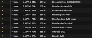

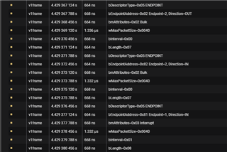

EK-TM4C129EXL: USB host with new class uses address 0 for bulk transfer after full enumeration
Part Number: EK-TM4C129EXL
Other Parts Discussed in Thread: EK-TM4C1294XL
I'm working on a project that needs to fully enumerate and send small commands via bulk transfer to a USB device of class Miscellaneous. To do that, I modified the USB Keyboard Host example so it could recognize and do the full enumeration of the desired miscellaneous class. When I connect the device to the EK-TM4C129EXL, the device is fully enumerated. Address 1 is assigned to it and it gets all the Device, Configuration, Interface and Endpoint descriptors (see screenshots below). The problem that I have, is that after the enumeration is done and I try to send a small command (using the function USBHCDPipeWrite) the host used address 0 and endpoint 0. So, there is obviously something I'm missing or doing wrong. Find the main file below as well as the screenshot of my data capture. Thanks for the help beforehand!

  • Hi Charles,
    In both, the original example and in my modified code, the communication starts with address 0. Then, before the host starts asking for the configuration descriptor, the address is set to 1. From there all the communication is carried using that address. The problem in my code is that when I declare an instance of the device in the host application code and later on use it to send the commands, the commands are sent with address 0, which it shouldn't happen since the address was already set. Looking at file usbhostenum.c, it seems like USBHCDPipeWrite() uses the pipe number to figure what endpoint to use to send the command, but there is no definition of address inside it.
  • Hi Alsiro,
    I wonder for the original HID keyboard example, only endpoint 0 is used for data transfer and hence the pipe is tied to endpoint 0 at address 0.

  • Charles,
    Thanks for your swift response.
    Regardless of the kind of communication that is used (Bulk, interrupt, Isochronous) the messages that are not control transfer, are sent via an endpoint other than 0. Then main issue I'm chasing, is that after the device has been assigned address 1 and the whole enumeration ends, when I try to send something via  USBHCDPipeWrite(), which is the function needed to send data other that control transfer, as is stated in the  TivaWare USB Library Host section, the data is being sent to address 0 instead. You can see this in the previously shared data captures.
  • Hi Alsiro,
      Yes, I see the host set the address to 1 in your capture but I don't know what is wrong. I also see that you have another endpoint for OUT transactions at EP2. For some reason, I don't know if this is inheritance to the HID library (for which you base off of) that it will only send an OUT transaction through EP0.

  • Just one more data point for your reference. I'm able to borrow a USB analyzer from a different team and rerun the Host_CDC example. Below are two screenshots. The first screenshot shows the enumeration process. If you look at Transfer 1  and 2, the ADDR is 0 and the ENDP is also 0. In Transfer 2, the host sets the new address to 1.  From Transfer 3 to Transfer 9, the ADDR changes to 1 while Endpoint 0 is still used for the remaining enumeration process. On the second screenshot, I can see that ADDR used is 1 while the Endpoint 2 is used for a BULK data transfer. The capture shows that ADDR=1 is used instead of ADDR=0. Earlier you said you could not even get the Host_CDC example to work at all. Can you rerun the Host_CDC example and be able to see at least what I see? This Host_CDC example creates a new host driver per the readme.txt instructions for the CDC class and the usblib.lib was rebuilt to reflect the new class driver. I will also suggest that you start with just one class, perhaps your IMAGE class instead of a composite device that consists of many different interfaces. It will be easier for you to debug a simple device than a composite device. Once you have a simple class is working, you can add others gradually.
  • Running the Host_Keyboard example, I see a Interrupt transfer type on EP1 with ADDR=1.
  • The class of my device is Miscellaneous, but it's got 7 interfaces. The interface that I need to send commands to has got a Image class. According to the USB User's guide, the value that is looked for is the interface class, which in this case is Image. Regardless, I've compiled the examples with both values and the result is the same.
