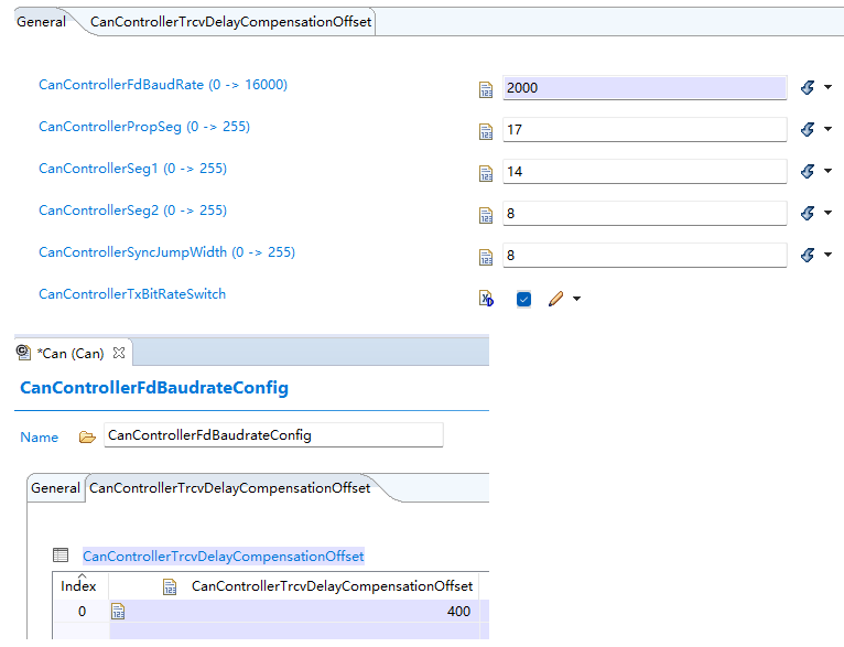

There are several problems in the configuration of CAN sampling points, which I would like to confirm:
1. The sampling point data segment configuration requirement of CANFD is 80% of the sampling points. In the following figure, are the configuration parameters that the total number of TQS is 40 and the TDCO is 400 correct? What are the recommended configurations?
2. Why the configuration in EB, such as the above configuration, can only configure 400 at most, doesn't that mean that only 80% (400/500) sampling points can be configured.
3.The description of the secondary sampling points in the manual is shown in the figure, whether it can be understood that the secondary sampling points are divided into two parts: the Delay Counter of automatic measurement and the TDCO in our EB configuration. Does the auto-measure part enable the SSP as soon as it is enabled?
4.Is there a way to test the configured TDCO? What is the impact if the TDCO in the first question is configured to 200?

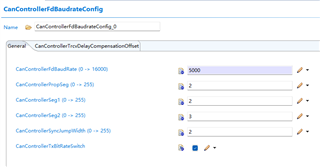

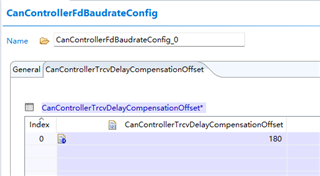

    The EB's default configuration is shown in Figure:
    CanControllerFdBaudRate:5000
    CanControllerPropSeg:2
    CanControllerSeg1:2
    CanControllerSeg2:3
    CanControllerSyncJumpWidth:2
    CanControllerTxBitRateSwitch :Enable
    CanControllerTrcvDelayCompensationOffset:180
    1.You mean that the TDCO is 180 also fits the configuration?
    CanControllerFdBaudRate:2000
    CanControllerPropSeg:17
    CanControllerSeg1:14
    CanControllerSeg2:8
    CanControllerSyncJumpWidth:8
    2.You mean TDCO is 180 fits SSP=80%, So is 100 or 400 right ?

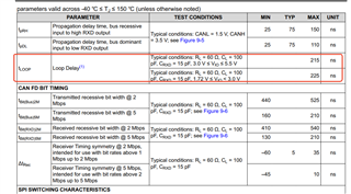

    1.Through calculation method of the EX, we can through the parameter as shown in figure calculated sspLocation, but we still can't confirm trcvDelayCompensationOffset parameters configured to how much is appropriate. Can you give us an appropriate parameter in the figure and explain why?
    In addition, the Can transceiver we used is TCAN1145.
    2.According to the information you gave, can I understand that the value of TDCO  can be set as the LOOP DELAY parameter of TCAN1145 (215 or 225ns), as shown in the following figure?
    3.If the second is true, can we understand that when sspPercentage is 80%, sspLocation=400ns, The compensatedSspLocation should be equal to sspLocation + trcvDelayCompensationOffset = 400 ns + LOOP DELAY = 400 ns + 215 ns. So compensatedSspLocation is 615ns.
    We assume sspPercentage is 100%, So compensatedSspLocation is 500ns+215ns, and the maximum compensatedSspLocation can only be 715ns.
    So why is sspPercentage 80%, TDCO is set to 400ns, compensatedSspLocation is 400ns+400ns > 715ns can still collect CAN data normally instead of displaying an error frame.

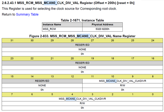

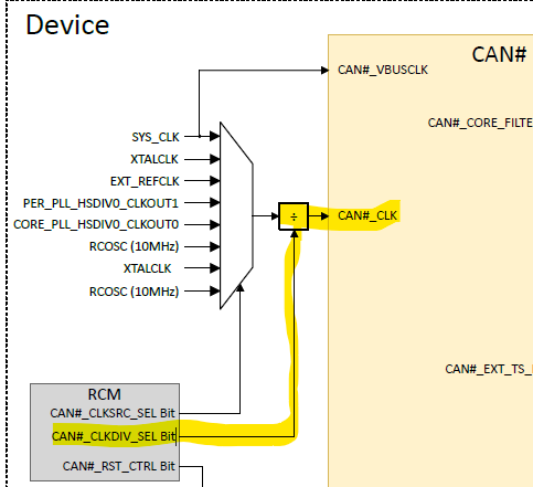

  • Hi Xinlei,

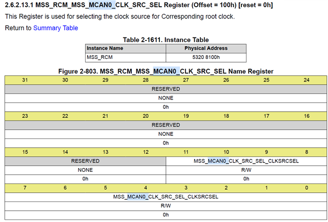

    The DBRP defines the length of the time quantum (the basic time unit of the bit time), and the bit timing logic (SEG1, SEG2, SJW) defines the number of time quanta in the bit time. Bit time (ns) is 1000 / baudrate(mbps).
    The MCAN functional clock source can be SYS_CLK, XTALCLK, etc.
    The clock source is selected by MSS_RCM_MSS_MCAN0_CLK_SRC_SEL
    For example, MCAN FCLK = SYS_CLK / CAN_CLKDIV_SEL Bit
  • tq = CAN#_CLK / DBRP
    bit time = (SEG1 + SEG2 + 1 (Sync) ) * tq
