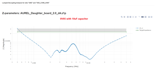

Customer's simulation is producing the following result:
As you can see, the simulation result is above the target impedance for a portion of the range <=1MHz, the peak being around 840kHz. We are wondering:
  1. Result is still acceptable for an AM6232 design?
  2. What suggestions do we have to improve the result?
Keep in mind that this customer design will only use the single and dual A53 core variants, and only up to 1GHz operating frequency, which should have a little bit smaller loading on the VDD_CORE rail than the four A53 core device at maximum operating frequency.
