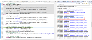

I now have a question about the MCAN ECC configuration to consult,I will describe the phenomenon of the problem below。
In my program, I execute can_init first and then SDL ECC Config. There is code in can_init to Enable or Disable ECC, which affects the SDL's ECC configuration. Below I use the demo program to simply explain the problem phenomenon.
① The first case

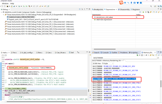

I use *(volatile uint32_t *)0x52700014 = 0; Code to simulate the MCAL CAN ECC Disable operation. You can see from the following figure that after SDL ECC initialization is complete, the value of MCAN0_ECC_CTRL is still 0.
② The second case
I use *(volatile uint32_t *)0x52700014 = 7 Code to simulate the MCAL CAN ECC Enable operation. You can see that the value of MCAN0_ECC_CTRL is 7 after the SDL ECC initialization is complete.
③ The third case
Perform only SDL ECC initialization, and you can see that the value of MCAN0_ECC_CTRL is 0x187 after initialization.
I did tests on all three, and the first one had an exception, the second and third worked fine.
In my program, the MCAL CAN module performs Disable ECC, using the first case. In this case, when the CAN driver receives a Message, ECC faults will be triggered and the CAN driver will be stopped.
I would like to know why the MCAL MCAN ECC configuration affects the SDL MCAN ECC configuration. I need to Enable MCAL MCAN ECC Enable? Or do I mask the MCAL MCAN ECC Config code?

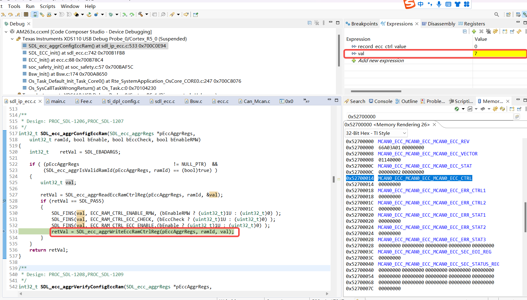

  • Hi,Jagadish!
    I ran some validation tests。
    ① When I simulated, I read the value of the MCAN_ECC_CTRL register when I entered the main function. You can see from the figure below that it actually read 0. Does this mean MACAN ECC is turned off by default?

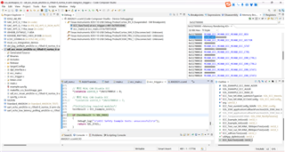

    ② I have tested the code of ECC configuration in SDL_ECC_Init, and it can be seen that the value of MCAN_ECC_CTRL is read in the code first. From the following figure, we can see that the value of val is 0, and then the bit0 bit1 bit2 of val is set to 1. Finally, write 0x07 to MCAN_ECC_CTRL.
    Why doesn't what I'm testing match what you're saying? Is there a problem with the way I'm testing?
  • Hi,Jagadish!
    Sorry, I made a mistake before, I should change the value of MCAN_ECC_VECTOR and then look at the value of MCAN_ECC_CTRL. After I do this, I find that the initial value of MCAN_ECC_CTRL after power-on is 0x187, which is consistent with what you said.

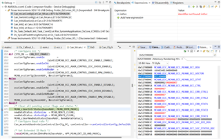

    However, when configuring SDL ECC, it will re-enable ECC regardless of the value of MCAN_ECC_CTRL, as shown in the figure below, which sets bit0/1/2 to 1.

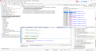

    After the execution of SDL_ECC_Init, I manually set the Vector register value. As you CAN see from the following figure, the value read back by MCAN0_ECC_CTRL is 7, which indicates that SDL_ECC_Init enables the ECC function again.
    However, my test found that although ECC was enabled, ECC fault was still triggered when I received CAN data. Why is this?
    Thanks.

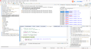

    (1) After disable ecc in can_init, I manually wrote 0x148000 to the VECTOR register, and then read back the CTRL value is 0.
    (2) After the sdl_ecc_init initialization is complete, I manually write 0x148000 to the VECTOR register again,and then read back the CTRL value is 7.

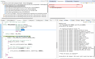

    (3) After the initialization is complete, I send the CAN message through the host computer, and the ecc fault will be triggered. The intrSrc is 3
    ② MCAL Can Enbale ecc
    (1)  After enable ecc in can_init, I manually wrote 0x148000 to the VECTOR register, and then read back the CTRL value is 7.
    In this case, the software CAN run normally, and the CAN module can send and receive data normally.
    As can be seen from the above two cases, after the completion of sdl_ecc_init, the value of the MCAN_ECC_CTRL register I read back is the same as 7, but the phenomena displayed by them are different. Why?
    Are you just calling the sdl_ecc_init initialization function? Are you not calling the ECC_sdlFuncTest?
    Actually ECC_sdlFuncTest should trigger the single bit and double bit ECC errors, i don't understand why sending the CAN packet from host to the board creating ECC faults.
