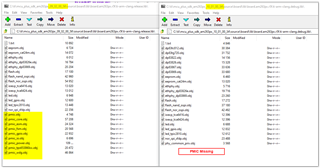

I updated from mcu_plus_sdk_am263px_09_02_00_56 to mcu_plus_sdk_am263px_10_01_00_34.
My project no longer compiles:
This is due to missing PMIC symbols in 'board.am263px.r5f.ti-arm-clang.debug.lib'.
<Q> Why have they been removed please?
