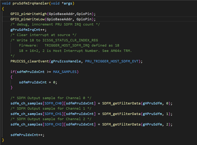

I wish to read sdfm current measurements at the center time point of PWM high phase AND at the center time point of PWM low phase.
Do you have an example? If not, could shed some lights on how to configure such an interrupt for reading sdfm values?
