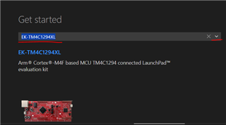

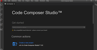

I am trying to dump example project in EK-TM4C1294XL but it is not getting detected in CCS.
I have downloaded the required SDK for this EK, also I have put the jumper settings according to given the manual. i.e. JP1 in ICDI position.
D0 led on the board is green , indicating power is there in the board.
With the help of schematics I verified that 3.3V is coming in the positions given in the manual.
I have attached the snapshot of CCS
