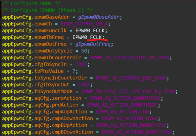

I have a question about PWM dead band time(after DBT).
Is there any limit of settable DBT [ns] or [clock]?
In sample Code ,"Single Chip Servo Motor Control",
I set some patarn DBTs(rise and fall).
PWM is 16[kHz], CPU time base clock is 250[MHz].
When DBT is less than 4 [usec](1000 clock count]) , PWM outputs same DBT I set in Both rise and fall.
But, when I set more than 5 [usec] (=1250 [clock count] ), PWM outputs does not work good.
Example acutual DBT is wrong, PWM doed not output.
P.S.
Fig.2 is PWM wave of rise.
I set DBT 10 [usec](2500[clock]), but actual is 1.8[sec].
Fig.3 is PWM wave of rise.
I set DBT 4 [usec](1000[clock]), actual is 4[usec] ,too.
regards.
Bun
