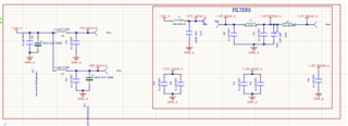

  • We used RMII as interface for MAC to Phy, Is there any issue with utilization of RMII interface in AM2634
    Apologies for the delay, do you have clearer photos of your connections so that I can double check the MAC to PHY connections?
    For missing packets, a likely cause is the timing. We have a enet_cpsw_loopback example as part of our SDK, are you able to test with that example? It would have to be modified for RMII.
    Susan
  • Could you please share your mail I will send you the schematic

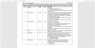

  • Yes, we have tested the MAC loopback using the enet_cpsw_loopback example by configuring the interface as RGMII as in TRM it was mentioned that the MAC Loopback functionality is applicable for RGMII only. Here attaching the reference of AM263x Register Addendum.

    I looked at the schematic, and I did not see anything I am concerned about right away. I spoke with our software expert, and we believe you may need to add some delay to the RMII lines for internal MAC loopback depending on why the packets are being dropped.
    Unfortunately we don't have any examples that add a delay.
    Are you able to print the statistics to see why the packets were dropped? Knowing if they were dropped because of an error or because there are overrun packets will help determine the best way to resolve the issue. In addition, I would check that the receive flow control is enabled.
