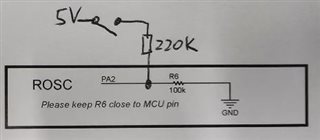

During testing on my MSPM0L1106 PCBA, I had the following questions and please help to provide me suggestion and solution :
Question 1 :
- MCU VDD = 1.8V
- A protential divider with upper R1=220K and lower R2=100K to GND.
- MCU PA2 is connected to the connection between R1 and R2.
- PA2 is configured as input without any pull resistor.
By using software and multi-meter to measure on PA2, the result are 0 and 0V respectively. When 5V is applied to R1, the same result is obtained. The expected result should be 1 and ~1.56V.
When R1 is changed to 22K, the measured result will be 1 and ~1.6V respectively. What is the cause of the problem? (Remark: this circuit is working with other MCU, 8051 core.)

    I noticed that there is a R6 pull-down resistor in the launchpad and it has the same value in my product. The following is the connection of my testing with lauchpad.
    I created empty project and configured PA2 as input without any internal pull resistor. I attached the whole project to you for your reference.empty_new.zip
    In my testing, when the switch is closed, PA2 should have ~1.5V. But my measurement is 0V.
    Inside the main() function, I added the codes that I set PA2 and PA3 to input and output. (Remark: they are disabled by default by #if and #endif.) I am locking forward on your analysis result. Thank you for your support.

    As for the voltage divider question you were asking, you are correct. The voltage there should be around 1 to 1.5V. There might be the possibility that the input is sinking some current going through the pin, so I'll test this out on my own and I'll let you know if I can replicate it.

  • Hi Alan,
    I replicated the setup and noticed a similar behavior to what you mentioned. When R1 is 220K, I get a value of around 22.588mV, while when using 22K, I get a value of 1.158V. The MCU could be draining some of the power at PA2. This could be because of how PA2/ROSC is connected to the FCL circuit of the MCU. My advice for now is to use another pin or a resistor value that gives the voltage you want.
    Diego Abad
