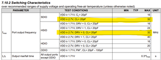

Q1) Trying to find an MSPM0G MCU which can drive CLK_OUT at 32MHz at 1.8V, but everything I can find seems to show I need VDD > 2.7V to drive at 32MHz.
Is there such a part, or is CLK_OUT pin a special driver with faster response at 1.8V?

    For clock out pin, you can find it in Table 6-3. Signal Descriptions in datasheet.
    Just search clock out.
    And you can find, in Figure 6-2. 64-Pin PM (LQFP) (Top View), all clock out function pin is
    HSIO, HDIO and SDIO in LQFP64.
