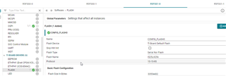

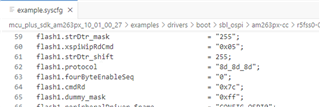

In order to allow the ability to read and write to a dedicated area of FLASH far away from any program code, Sysconfig was used create a FLASH config and the associated OSPI config. Note that I am not using LittleFS or FreeRTOS FAT for this; just the normal FLASH read and write calls. The code builds just fine, however on startup, since it starts from FLASH, there is a very long delay, on the order of 3-5 *minutes* before the program actually starts executing after it is programmed into FLASH.
If the 'Skip HW Init' flag is set, the delay goes away, but then none of the functions that would allow me to erase, read or write to FLASH work at all; they always return a failure.
