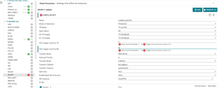

I want to use AM2634 in peripheral mode with DMA and currently using mcspi_loopback_dma example code for reference, for 8 byte this example working fine mean it's generate interrupt after getting configured received bytes, but  whenever  change to 8 to 1 its not receiving data any more mean I want interrupt on every single byte reception,
attached image shows that its giving two time(Yellow) interrupt while sender(Master) sends 8 bytes, Chip select (violet)
please suggest how to configure  SPI data reception interrupt on single byte in DMA

  • Rohal,
    The way driver is configured, you need to provide total number of bytes/count and data size. Please check arguments of
    MCSPI_transfer api in mcspi_v0.c file. On basis of this you will get interrupt. Let say your count is 128 bytes and data size as 1Bytes.
    1st way (without FIFO):  The total number of interrupt you will receive is 128/1bytes. i.e. on every transaction you will receive an interrupt.
    2nd way (with FIFO): Assume FIFO trigger level as 16, i.e after every 16 bytes, you will get an interrupt. So, in this case total number of interrupt is 128Bytes/16Bytes = 8.
  • how to disable fifo  because it's not allow to make it Zero

  • Rohal,
    spiTransaction object configuration seems to be correct.
    By default, driver is using FIFO there is no way to disable it from GUI or from the application. If you still want, I can guide, you the process to disable it but you need to make changes in driver which I would suggest not to do.
  • Please guide in steps how to disable fifo in driver and let me check the behavior, if it fulfill my requirements then ok other wire i'll make it reverse
  • Can you try commenting out MCSPI_setFifoConfig in MCSPI_lld_write and MCSPI_lld_read api If you are in polled mode. For Interrupt mode use  MCSPI_lld_readIntr and MCSPI_lld_writeIntr.
