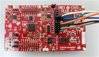

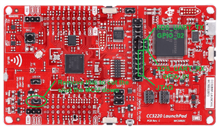

I want to connect the JTAG and XDS_UART_TX & XDS_UART_RX from CC3220SF EVAL BOARD to the PRODUCT PCB. PRODUCT PCB uses CC3230SF MCU. The expectation is that I will be able to program the PRODUCT PCB. However, as I tried multiple times using multiple codes/projects, I could still not do that.
Below is the MCU EVAL BOARD picture. In this EVAL BOARD, I disconnected the J9 jumper to shut down the EVAL BOARD MCU. I also removed the jumper from J3 (JTAG) and J6 & J5 (XDS_UART_RX & XDS_UART_TX) and connected the jumper cables to the side green boxed below.
The picture after the jumper cable connection is shown below.
When I did that, we faced unique issues. During the Build, all the SDK Codes/Projects have issues.
