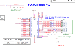

    Thanks for your reply. I understand the use case of chip select, but for this particular custom board, we are using a high-speed switch to control both PSRAM and Flash. So, why do we need chip select? I've attached a screenshot for your reference.
    (Please check this link: Beyond-SDK/am243x/examples/ospi/ospi_psram_io/am243x-evm/r5fss0-0_nortos/Docs at main · TexasInstruments/Beyond-SDK · GitHub)
    Since the hardware uses two chip selects, we need to control them as well as the high-speed switch. Could you please explain how we can manage these two devices in the codebase?

  • Hi Anand,
    I had a quick discussion with Paula who had more context on this.
    I believe based on the schematics, when the switch happens, all the lines gets switched where:
    1. OSPI1_xxx is OSPI Flash
    2. OSPI2_xxx is PSRAM - OSPI RAM
    Could you please verify the steps you are doing between calling PSRAM open and Flash Open?
    I am assuming you are atleast doing the following:
    PSRAM open
    Switch logic
    Flash open
    Please correct my understanding.
    Vaibhav

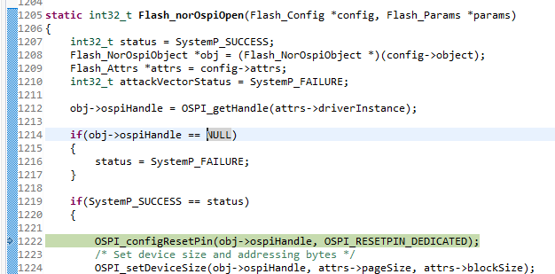

  • Hi Anand,
    When inside Flash_open, can you narrow down to where the error occurs?
    Can you step inside Flash_open() API and let me know where exactly the exception or the error is thrown.
    Please share screenshots if possible.
    Note:
    I also want a snippet of the config values as shown in the screenshot below.
    Take this snapshot when you enter the API Flash_norOspiOpen and then when you go to the line
    Looking forward to your response.
    Vaibhav

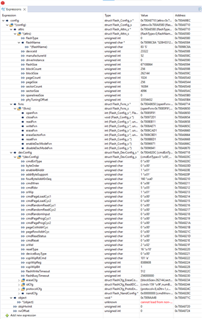

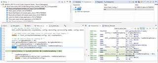

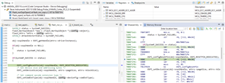

  • Hi Vaibhav,
    Please check the below screenshots,
    1. config values:
    2. Screenshot at function - Flash_norOspiOpen
    The issue lies with the Flash_norOspiReadId() function, which consistently returns a failure, causing the Flash_open() function to fail as well.
    Screenshot:
    You can reproduce this issue with the specific EVM by first loading the PSRAM example code (which will work as expected). Then, without performing a power-on reset, try loading any flash example. I am using the ospi_flash_io_am243x-evm_r5fss0-0_nortos_ti-arm-clang example. You will notice that the example code fails to open the flash.
    (For this particular test, in the Flash_IO example code, I am closing the flash and driver, performing a system deinit, and then reinitializing everything. Despite these steps, it still does not work.)

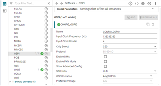

  • Hi Anand,
    All the values which you have shown look absolutely correct.
    I want to ask one thing, what is the clock frequency and clock divider value you have set in OSPI section of the application's SysConfig?

  • Hi Vaibhav,
    I have attached the screenshot of clock frequency and divider value of OSPI,
    Since I'm using the SDK example, I haven't made any configuration changes.
