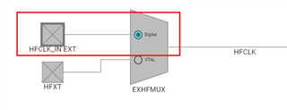

    Here is another way:
    We can not bring external 32MHz through clock system to Timer.
    Unless you are using HFCLKIN function, this is a digital clock source for MSPM0, this will bring all MSPM0 system's clock source from external 32MHz.
    Also include the TIMG12. HFCLK_IN_EXT from Device pin to SYSPLL, then to CPU and all peripherals.
    This clock will control the timer count increase.

    There is another way that I mention:
    The only real choice to drive TIMCLK is BUSCLK ← MCLK because all other choices are too slow.
    But this need external 32MHz continuously input to MSPM0.
    Yes, TIMG12 max clock speed is 80MHz from MCLK.

    So, we can not bring external 32MHz into MSPM0 as system clock.
