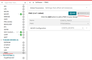

  • Hi 亨 平田
    If PMIC is added, could you remove it and then try to build the example!
    Akshit

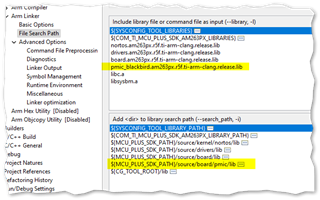

  • In the latest SDK, TI have moved the PMIC code to 'pmic_blackbird.am263px.r5f.ti-arm-clang.debug.lib' or 'pmic_blackbird.am263px.r5f.ti-arm-clang.release.lib'.
    You need to include either of the above libraries in your linker step.
    See the background here:
    (2) MCU-PLUS-SDK-AM263PX: v10.1.0.34: PMIC Object Code is Missing From Board Lib - Arm-based microcontrollers forum - Arm-based microcontrollers - TI E2E support forums
  • Hirata-san, Are you sure you have selected the correct answer to your problem?
  • The linker error was resolved by deleting the PMIC in SysConfig.
    Thank you.
  • The linker error "goes away" but you still need the PMIC LDO4 for the ADC to work correctly as per (+) MCU-PLUS-SDK-AM263PX: Problem with PMIC LDO4 not working in AM263Px ADC example on control card - Arm-based microcontrollers forum - Arm-based microcontrollers - TI E2E support forums
    LDO4 is not switched on by default.
    The answer is not to delete the PMIC configuration, the answer to add the PMIC library ('pmic_blackbird.am263px.r5f.ti-arm-clang.debug.lib' ) to your project as per my previous post.
    You need these in your project when using SDK 10.1.0.34:
    Try deleting the whole project and reimporting the example from SDK 10.1.0.34.
  • Hi, Kier
    By adding the PMIC library ('pmic_blackbird.am263px.r5f.ti-arm-clang.debug.lib') to the project, the linker error disappeared.
    Also, I was able to turn on the PMIC's LDO4 in the ADC example.
    Thank you very much. It was very helpful.
