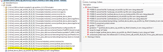

    The patch which we shared with Santosh is originally based on top of Industrial Communications SDK 09.02.00.15. Kindly ensure that the patch is applied on top of this version of SDK.
    We followed the read-me instructions found in the folder.
    Below is the error that we have. even when the library path to the project file was included. Please provide a suggestion for this.
    Chockalingam N
  • Hi Chockalingam,
    Regarding the build failures, this is caused due to not copying all the libraries to the CCS project path(Default location: C:\Users\<username>\<ccs_workspace_name>\profinet_device_demo_xip_am243x-lp_r5fss0-0_freertos_ti-arm-clang) . This additional workaround is required and is mentioned in the 2nd step of the readMe file.
    "2. Copy all libraries present in path: ({ind_comms_sdk_am243x_09_02_00_15_path}\source\industrial_comms\profinet_device\stack\lib) to the CCS project path."
    Could you make copy the libraries and try the build?

  • Hi Laxman,
    Thanks for the information.
    After I implemented the extra workaround, the project is now created error-free and has produced both.hs.fs and.xip images.

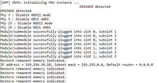

    The following prints appears in the terminal window.

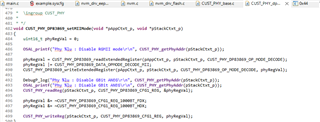

    Is it okay? The CUST_PHY_dp83869.c code mentions PHY values to print, but I'm not seeing any prints in the terminal.
    I then tried to find our device in testing tools such as PRONETA (Siemens) and Profinet device monitor (Port-Command line tool).
    Our device is not recognized by it. The image file may not load properly, I believe. Additionally, I added a debug log to print the PHY values.
    I flashed the image files and repeated the process, but the terminal still showed same prints.
    Please confirm what prints we would get in the terminal after flashing the default patch file to AM2434LP without making any changes.

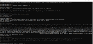

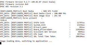

  • Hi Laxman,
    The following prints appear in the terminal after I flashed the shared binary file using the bootloader SDK 09.02.00.15.
    The default_sbl_ospi cfg commands below, I copied the shared binaries into this location.
    # First point to sbl_uart_uniflash binary, which function's as a server to flash one or more files
    --flash-writer=sbl_prebuilt/am243x-lp/sbl_uart_uniflash.release.hs_fs.tiimage
    # Now send one or more files to flash or flashverify as needed. The order of sending files does not matter
    # Program the OSPI PHY tuning attack vector
    --operation=flash-phy-tuning-data
    # When sending bootloader make sure to flash at offset 0x0. ROM expects bootloader at offset 0x0
    --file=sbl_prebuilt/am243x-lp/sbl_ospi.release.hs_fs.tiimage --operation=flash --flash-offset=0x0
    # When sending application image, make sure to flash at offset 0x80000 (default) or to whatever offset your bootloader is configured for
    --file=sbl_prebuilt/am243x-lp/profinet_device_demo_xip_am243x-lp_r5fss0-0_freertos_ti-arm-clang.appimage.hs_fs --operation=flash --flash-offset=0x80000
    # send the XIP image for this application, no need to specify flash offset since flash offset is specified within the image itself
    --file=sbl_prebuilt/am243x-lp/profinet_device_demo_xip_am243x-lp_r5fss0-0_freertos_ti-arm-clang.appimage_xip --operation=flash-xip
    The execution of those commands is successful.
    Chockalingam
  • Hi Chockalingam,
    Looks like the complete UART log is not printed for the initialization sequence. Could you let me know which revision of AM243x-LP board are you using?

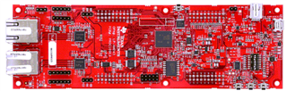

    I'm now utilizing PCB # PROC109A version of LP-AM243.
    Chockalingam
  • Hi Laxman,
    Today I tried with another hardware of LP-AM243x, PCB # PROC109E3 version and flashed the shared binary file using the bootloader SDK 09.02.00.15 the following prints am getting in the terminal.
    Prior to parsing default_sbl_ospi.cfg, I'm parsing default_sbl_null.cfg. Both are running successfully, but our expected prints are not appearing in the terminal.
    Chockalingam
  • Hi Chockalingam,
    I would recommend to test with only PROC101A as this is the latest version of board and all the tests have been done on this board.
    As mentioned in the documentation shared with the patch, the power cycle of the device fails few times occasionally. Do you observe the issue even after multiple power resets of the device? If you have other AM243x-LP PROC101A. would it be possible to test this on different board?
    I will also test with multiple boards and check whether this issue is reproducible.
    Laxman
  • Hi Laxman,
    Are you referring to the most recent PROC101A board version for the AM64x/AM243x GP EVM PCB?
    For our project right now, we're using the AM2434_ALX package SoC. Is that a proper HS device? Therefore, we used the ALX package's Launchpad LP-AM243. There are only two variations that we have right now
    1.PROC109A
    2.PROC109E3
    Would you kindly confirm that the provided patch file is compatible with this?
    Chockalingam
  • Hi Chockalingam,
    Apologies for the confusion, I mean PROC109A board revision for AM243x-LP.
    Laxman

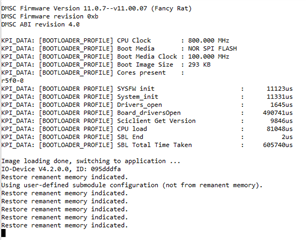

  • Hi Chockalingam,
    I have tested the binary on four AM243x LP. Two of them with model PROC109A and two of them with model PROC109E3. I see that on one of the PROC109E3 board, the intialization sequence does fail.
    However with the PROFINET application on 11.01 baseline, I see that all the initialization steps are executed correctly on the PROC109E3 board. I am sharing another patch which includes all necessary binaries and flashing images for your testing.
    This SDK is not yet out for release and we will provide an update once this is available for public.
    Kindly run the test after following the instructions mentioned in the readMe and let us know if you face any issues.
    Drive Link: https://tidrive.ext.ti.com/u/-gFP-kgBT7XoAU_j/010e39df-89aa-4a05-a207-a369dafbff3a?l
    Access Code: Y2D2cy]U
    Laxman

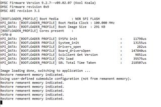

    Following the instructions in the readme, I tried your shared binaries on two AM243x-LP that we have on hand. Two of these are PROC109A and PROC109E3. Both boards are giving me different outputs, which I have included for your reference.
    1.Board - PROC109E3 - Terminal Prints
    2.Board - PROC109A - Terminal prints
    Chockalingam
  • Hi Chockalingam,
    The application initialization is successful in the PROC109A board based on the UART logs shared. However looks like on PROC109E3 board the issues are still observed. We would recommend to continue your testing with PROC109A board as this is the latest board version.

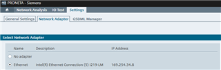

    Do you observe the PRONETA tool detecting the device?
    For PLC communication you can use the GSDML file from our latest Industrial Communications SDK.
    Laxman
  • Hi Laxman,
    We copied the most recent GSDML file from the Ind. Comm.SDK to the PRONETA tool so that we could test with our device. We also enabled the SNMP and UDP ports on our PC as instructed in the documentation. Other than that, is it necessary to set up our PC to a static IP address or something? since I can't see our device in it.
    Is there any static IP set up on our Lp-Am243x profinet slave device?
    Please give me some advice on this.
    Chockalingam
  • Hi Chockalingam,
    To detect the device in PRONETA, you do not need to load the GSDML in the tool. You can select the Network Analysis option and the topology should be directly visible. No need for any special configurations for IP address is required.
    By default there is no static IP address set to the device. Normally the PLC or PRONETA tool is used to set the IP address of the device.
    Do you have any other PROFINET device or PLC to check whether the tool is configured correctly?
    Laxman
  • Hi Laxman,
    After reconfiguring and removing the GSD from the tool background, the PRONETA tool was able to recognize our PROC109A device.
