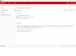

LP-EM-CC2745R10-Q1: Chip Erase not possible in UNIFLASH
Part Number: LP-EM-CC2745R10-Q1
Other Parts Discussed in Thread: UNIFLASH, CC2340R5
In this post LP-EM-CC2745R10-Q1: Issue with CC2745-Based MCU on TI LaunchPad it is mention how to do Chip Erase with UNIFLASH, but this feature is not available for CC2745R10?
    Yes, this feature is not supported on the CC27xx right now. I'm getting some more information about when it will be supported. I'll let you know tomorrow.
    Nima Behmanesh
    It appears that it's not in the plan to support chip-erase through Uniflash as of now. However, you can still do chip-erase through CCS.

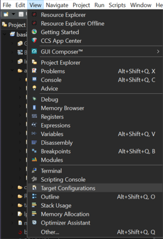

    1. Click on View --> Target Configurations:

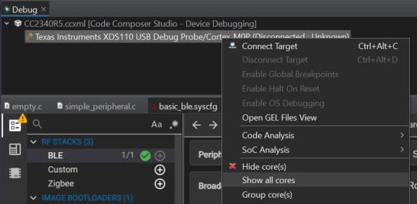

    3. A debug window will have popped up. Do not connect. Right click on Texas Instruments XDS110 USB Debug Probe... and click Show All Cores:

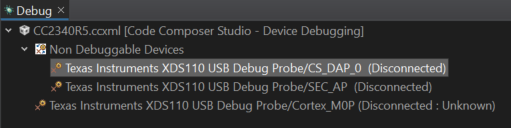

    4. Expand Non-Debuggable Devices and click and highlight, but do not connect, Texas Instruments XDS110 USB Debug Probe/CS_DAP_0:
