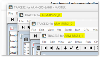

I ran '_am263px_allcoretype_connect.cmm' script expecting to see at four instances of TRACE32 for ARM-R5xxx. However, I only get the following:
My project is R50_0, R51_0 and R51_1. (R50_1 is in lockstep mode).
I want to use Data,LOAD.Elf for R50_0, R51_0 and R51_1.
<Question>
  • It seems that 'ARM-R5SS0' = R50_0 and 'ARM-R5SS1' = R51_0, is that correct?
  • If so, where is the instance for R51_1 in order to load its .out file please?
  • If not, please correct my misunderstanding.

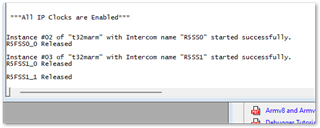

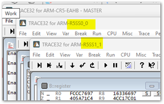

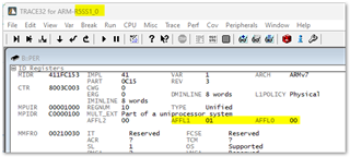

  • Hi Richard,
    OK, I got as far as creating two instances and releasing both cores in SS1. I'm using the following script now:
    This seems to make all the right noises:
    However, this still only gives me two instances, one for each subsystem. As far as I can see, I can only view one set of Registers in SS1, I assume this is Core 0 (aka. R5FSS1_0).
    The questions remain though:
    - How would I view the registers of the second core in SS1 (R5FSS1_1)?
    - How would I load the ELF file to the second core in SS1 (R5FSS1_1)?
    Thank you.

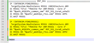

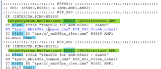

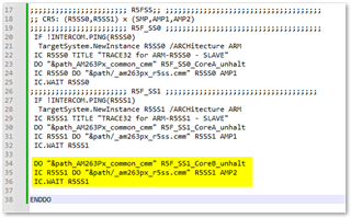

    Following the pattern, I have:
    Above I'm trying to creating a second instance of R5SS1 (R5SSy) on lines 34 to 39 and passing the AMP2 argument. However, only one instance (for subsystem 1), the last instance to be created in the script, remains:
    The first subsystem 1 instance is missing, presumably closed when the second instance was created.
    Are you able to try this your end please?

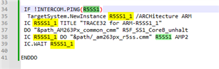

  • Actually, I may have just stumbled on the correct syntax:.
    Looks like the argument to INTERCOM.PING() and _am263px_r5ss.cmm should remain as 'R5SS1' (green) but all other subsytem references are R5FSS1_1 (yellow):
    I repeated the same pattern for the first instance.
    I now have 3 GUIs to work with.
    Remains to be seen if these are actually connected to the right core. Here's the script I now have:

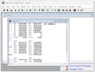

  • OK, the 3 GUIs should allow controlling each core independently.  You can load some unique code onto each, or do 'data.assemble' (create simple per core unique code code) then set the pc to step it.

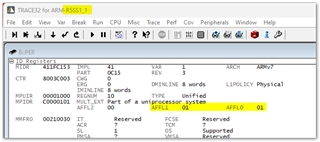

  • Thanks for the leg up Richard.
    I have confirmed the correct cores are attached via the MPIDR register.
    I have also modified _am263px_r5ss.cmm and loaded the correct program for each code and they each run to main(). So I'm good to go....almost.

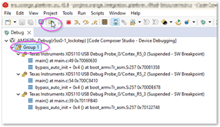

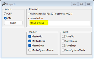

    Last question please: I wish to start (Go) all 3 instances simultaneously. How to 'Go' for all cores simultaneously please?
    The equivalent in CCS would be clicking on core Group 1 and hitting Resume:

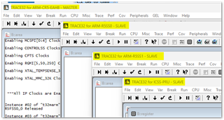

    Thanks for sharing the feedback about your progress.  The MPIDR is a good way to get confidence in the core to GUI mapping.  My method was based on address mappings and what is in specifications which was correct, but the MPIDR is even a better correlation point.
     For grouping with action rules the common method would be to use the synch command. By default it will use a debugger network port based synchronization.  If a faster method is needed CTI's can be setup.  I made a short video to demonstrate on a am263p EVM.
    Richard W.
  • Many thanks for the video Richard, just what I needed!
    For subsequent readers, you can just put two slaves separated by a space in the master's connect list:
