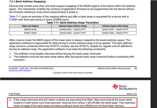

I'm implementing a firmware update using the CSC policy. In SysConfig, under the Configuration NVM (NONMAIN) section, I enabled "Enable CSC Policy" and "Enable Flash Bank Swap Policy." I then programmed the microcontroller, selecting the "Erase MAIN and NONMAIN memory" method.
The issue occurs when the CSC code attempts to swap the banks; specifically after calling DL_SYSCTL_issueINITDONE(), which follows DL_SYSCTL_executeFromUpperFlashBank().
if(bankswap == SWAP)
DL_SYSCTL_executeFromUpperFlashBank(); // Set swap bank0 to bank1
delay_cycles(160);
DL_SYSCTL_issueINITDONE(); // Issue INITDONE to trigger System Reset -> swap to bank1
else
DL_SYSCTL_issueINITDONE(); // Then issue INITDONE to trigger System Reset
