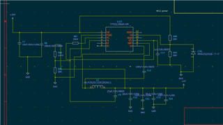

Hi Support,
Currently I have Design the Schematic
Input Voltage is 24V
Output Voltage is 5V
but i have get it 0.8V only at output point.
regards
Saurav

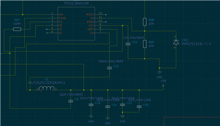

Hi Saurav,
The VCC capacitor value is wrong (C14). It should be1uF, not 1nF. Pls change it. When you power on the device, pls test VCC and EN voltage at first. If these two voltages are wrong, the device cannot work normally. Thanks.
Aurora
Hi Saurav,
If you cannot get VCC voltage after start up, this may be caused by the chip being damaged or not being soldered properly. If the chip is well soldered, you should be able to detect a diode to ground between each pin and GND using a multimeter. Please eliminate these problems first. In addition, the power supply can be current limited when powered on for the first time, and the initial debugging voltage can be lower, such as 12V. Please make sure that the chip has EN and VCC voltages after power-on, and the voltage values are normal (from your schematic, they should all be 5V). Thanks.
Aurora
