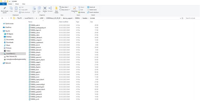

this is for C2000 series controller (F280025c) like this, I need device support files for sitara am2634.
this device support folder contain , header files for the all peripherals and global variable definition header file for accessing the Registers structures, common folder contain some common device drivers for Cpu CLK, PIE, syscntrl.
Hi Manoj,
Similar files could be found in MCU PLUS SDK here:
https://github.com/TexasInstruments/mcupsdk-core/tree/next/source/drivers/hw_include/am263x
Let me know if this helps
