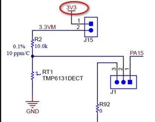

My customer is developing M0L1306. They try to use ADC to detect thermistor. They ask if their VDD (3.3V) tolerance is 5%, how could they measure the accurate temperature ?

This will depend of the thermistor you are using. I will read its datasheet to determine if the VDD tolerance could affect the readings from it. As in for the M0L1306, the only advice will depend on which VREF you use for your ADC. If you use VDD as reference, I'll recommend to review the formula that our ADC uses to convert the input signal into a digital value. If you use the internal VREF (1.4 or 2.5V,) this should not affect the readings (the same applies if you use a external VREF.)

My customer refer to LP-MSPM0L1306, but they use different thermistor (NCU15WF104F60RC). Please check its spec. and customer want to make sure if 3.3V become 3.25V, how could they make sure if the ADC read correct value ?
Hi Jerry,
The MSPM0L1306 ADC will be able to read any reading from the thermistor. I recommend consulting Murata Electronics about this since they would know better how their thermistor will behave under a sudden change in value and any example circuit on properly setting the thermistor for readings.
