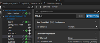

Trying to use SYSCONFIG with MSPM0G3519 but RTC function is missing.
It is there in the MSPM0G3507 but not for the 3519, but the spec shows RTC_OUT available on three pins in the LQFP-64(PM) package [PA13/6, PA27/31, PA9/55].
Can this be please added this to the list to fix?
