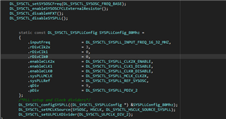

Clock sysconfig configuration:
1. Explanation of the Issue:
a. I am using the internal system oscillator (SYSOSC) at 80 MHz on the MSPM0G1507 and have configured a PWM with a period count for 2 kHz. However, I am observing unexpected frequency variations in the output waveform:
Single Initialization: The measured PWM frequency is 2025 Hz, which is higher than the expected 2000 Hz. This deviation suggests a high frequency tolerance issue.
Double Initialization (Calling Initialization Function Twice): The output frequency is now in the range of 2005-2015 Hz, which is much closer to the expected value.
Is it expected that MSPM0G1507 requires re-initialization to correct this issue, or is there an alternative way to ensure accurate PWM frequency on the first initialization?
2. Issue with FCL Application:
a. I tested logic and found that the DL_SYSCTL_enableSYSOSCFCLExternalResistor() function plays a major role in clock tolerance.
If I remove this function, I consistently get an out-of-tolerance frequency, around 2030 Hz (exceeding the 2020 ±20 Hz limit).
Even with two initializations, I still observe the same out-of-tolerance frequency.
b. When using DL_SYSCTL_enableSYSOSCFCLExternalResistor() for FCL, I still see inconsistent results:
i.On the first initialization, the frequency is 2025 Hz.
ii.On the second initialization, the frequency drops to around 2003 Hz.
This raises a doubt: Is FCL not applied during the first initialization but only on the second one? (Note: The FCL mode is enabled on the first attempt itself.)
