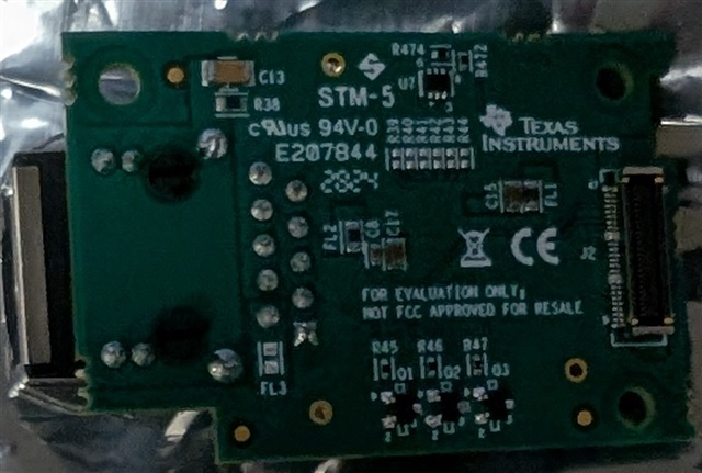

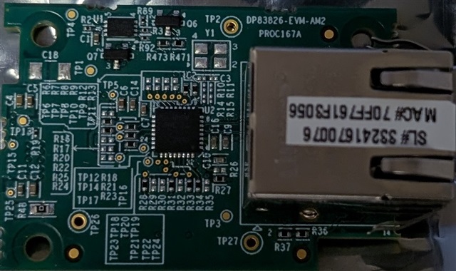

  • Hi Shaunak,
    I have taken some photos of the DP83826-EVM-AM2 that we are using.
    Please let know if if there any more information that you need.
    Best  regards
    Daniel
  • Hi Daniel,
    Thanks for sharing the details. Let me check internally with the team on the possible steps here to move ahead.
    Shaunak
