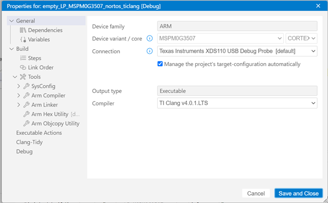

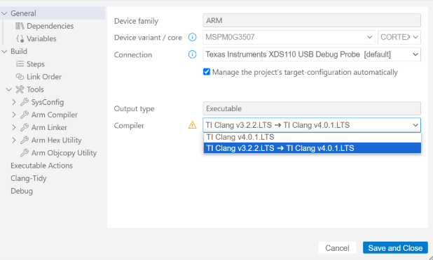

Below is the Current Compiler version,
We tried the using the empty project thats available in the path: ti\mspm0_sdk_2_03_00_07\examples\nortos\LP_MSPM0G3507\driverlib\empty and copied the function '__STATIC_INLINE   void invokeBSLAsm(void)' . When we build this project its getting compiled successfully.
Below is the Compiler version for empty project,
Kindly let us know the root casue of this issue and Let us know the possible solution to resolve this issue on priority
