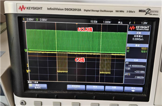

I am currently using the SPI function of the MSPM0G3507-Q1 chip; The following is my function introduction, I set MSPM0G3507-Q1 as the host, set ADS8688 as the slave, the host sends the command code (0x00000000,0xA0000000), the data is collected from the slave machine and returned to the host. This is the process I expected, but during use, I could not receive the data returned by the machine (to be precise, I set the receive interrupt in the program, and added the breakpoint verification in the interrupt, entering the interrupt is normal, but I can not read the data in the RxData register, I detected the status of RXFIFO, I can not read the data in the RXdata register. It appears as non-empty). I used oscilloscope PICO, POCI, CLK, CS pins in the slave machine to display whether the waveform was correct. What are the reasons for this? How to deal with it?
Below is part of my program code and oscilloscope picture

  • the host sends the command code (0x00000000,0xA0000000)

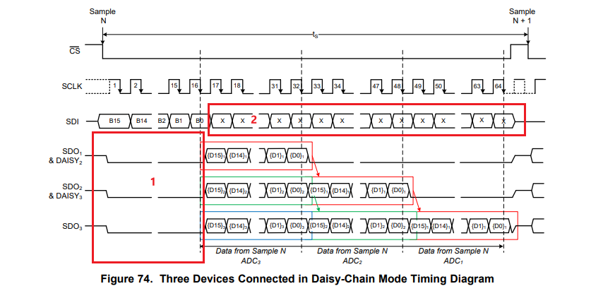

        8.4.1.1 Digital Pin Description
        And 8.4.1.2 Data Acquisition Example is the SPI communication sequence that we need to control ADS device.
        You need to control MSPM0's SPI follow the steps in 8.4.1.2 Data Acquisition Example.
    Region 1 is used to send commands to the ADS, and you also receive some useless data from Rx.
    Also, in region 2, to read data from the ADS, you need to send some useless data such 0xFF or 0x00 to enable SCK, so that the clock is active so that the ADS has a chance to send data back.

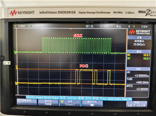

    e2e.ti.com/.../mspm0g3507-q1-the-spi-communication-cannot-read-the-rxdata-register
  • My current situation is that the slave can send data, in another post, the POCI pin waveform of the oscilloscope proves this (and the data is correct), I can now trigger the SPI receive interrupt, but the data cannot be read in the RXDATA register

  • According to the oscilloscope waveform image collected in another post, my sending process is to send 0xA0000000 once, and then send 0x00000000 eight times. The logic flow of SPI communication code is verified on another type of chip, and then ported to MSPM0G3507. When my RXFIFO check, the display is not empty, but also can trigger an interrupt, indicating that the data has come back, this inference is no problem. But it can't be read in RXDATA register, now that's the problem

    But I still don't know how to control ADS, this is depending on ADS's datasheet, such as
    how many bytes need to send to ADS as command, how many bytes I need to receive from ADS.
    But from this figure above:
    command seems to be 16bit and received data is depending on ADS device number.
    From send to read finishing, the valib data should be 17th to 32nd bit.

    At this point, my slave currently has only one ADS8688 acquisition chip, and the oscilloscope picture I uploaded is equivalent to 0xA000 in region 1; In region 2 (from bit 17 to bit 32), 0x0000 is sent; I only need to read a piece of content from the slave;

  • At this point, my slave currently has only one ADS8688 acquisition chip, and the oscilloscope picture I uploaded is equivalent to 0xA000 in region 1; In region 2 (from bit 17 to bit 32), 0x0000 is sent; I only need to read a piece of content from the slave;
    Yes, there will be some bytes received in region, these part is useless, you need to read them out from SPI rx (FIFO).
    Also, the next received data is valid.

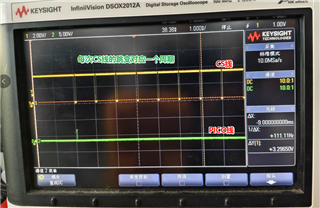

    emmmm, yes, there are SCK all time time. Time scale is 1ms, and you read ADS data every 1ms, correct?
    Receive function, need to continue to call SPI_TX32 function to handle?? What's the logic?
    Actually, yes, after send command, M0 need to send 0x00 to enabled SCLK.
    Since your scope capture time scale is 1 ms, I can not see the detailed information, could you please show me your single sequence of Tx - Rx wavefrom?
    Need to confirm the valid data come with which group of 16bits SCLK.
    My SCLK always has a waveform.

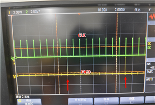

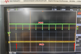

    The waveform data is shown below
    Do you know which group Rx data is valid? How to confirm in software?

    I can't receive it in the software, which is my current problem. But according to the POCI and SCLK waveform, the last 16 bits are the data I want to receive, send command to process RX data, this part is what I said to send 0x00000000 all the time
  • I can't receive it in the software, which is my current problem. But according to the POCI and SCLK waveform, the last 16 bits are the data I want to receive, send command to process RX data, this part is what I said to send 0x00000000 all the time
    Yes, I also seen this.
    Since you send your command, then you need to read data from SPI FIFO.
    You will receive 2bytes after you send command, this part is region, useless, it's 0x0000.
    Then you need another two bytes to be received from SPI FIFO, this part is region 2, received data from ADS.
  • What is the next operation or processing? (Now it is known that when the MSPM0G3507 chip communicates with SPI, users cannot directly operate SPI-FIFO. There is no corresponding interface, and they can only operate the RXDATA register. For FIFO operations, only the status bit is used to detect whether there is data in it.)
  • RXDATA is the FIFO access interface.
  • Can you be more specific about what I should do in the code, or what should I change in my existing code
  • How do I operate the rxdata register to read the data in the ADS collection area 2
  • How do I read the data in area 2
    You SPI.RxCount need to set tx_count + rx_count.
    First tx_count length of rx data is from region 1, next rx_count length of rx data is from region 2, SDO.
  • Based on the amount of data I want to receive, my RxCount value is set to 4 according to your method, but my test array TEST_arr1 never has any data
  • I added the test point inside the 0x4 interrupt, entered the interrupt twice in 32 clock cycles, my SPI.RxDataW type is 16 bits (2 bytes), as expected, in SPI.RxDataW[1] is the data of region 1, in SPI.RxDataW[0] is the data of region 2, but the result is, The data content is always 0, which is inconsistent with the oscilloscope. According to your introduction, SPI.RxDataW[0] is the other 2 bytes you refer to, because the value of SPI.RxCount decreases by 1 with each interrupt.
  • This is strange, the data should be received and your interrupt has entered.
    Yes, it's weird. The above problem description is a problem that I haven't solved so far, but neither the oscilloscope waveform nor the logic of the code are checking for errors. Receive interrupts are also triggered with the clock waveform. Please communicate with your engineering team to solve it as soon as possible. Before, I applied for your engineer to come to my site to solve the problem, but it was not successful
  • For this issue, please try to use a SPI demo in MSPM0 SDK, to setup a simple communication with ADS device.
    SPI demo in MSPM0 sdk is fully test.
    And another tips, is this SPI software test on other project or platform.
    Both two recommendation is used to confirm whether is a software issue.
    On hardware side, please confirm whether the signal line is connected.
    Or try to set the POCI to GPIO output and observe whether there is voltage toggle at the same test point.
