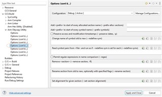

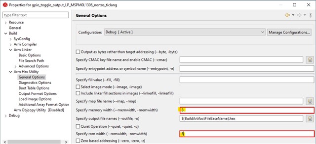

There are multiple options in CCS’s ‘Project Properties-> Arm Hex Utility->Output Format Options:
I tried all of them and it appears that the only correctly generated file is ‘Binary’ file.
The Motorola S files don’t look correct either
