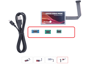

The board I'm using is the TMS570LC4357HDK. The board has an arm 20 pin external jtag probe.I purchased the TMDSEMU200-U emulator.Want to use this emulator to emulate and burn programs.
I'm having a problem with not being able to connect.
1. The emulator is shown below
2. The list of device managers is shown below
3. The connections are as follows
4. CCS 12.8.1 is configured as follows
5. The test connection error log is as follows.

In response to the above steps, I would like to ask if the emulator can be used in this way, and if so, is there something wrong with my steps? I am confused as to why it is reporting an error.
It's worth noting that I've reinstalled the TMDSEMU200-U driver.
Please help analyze the problem and reply as soon as possible, thank you very much!
