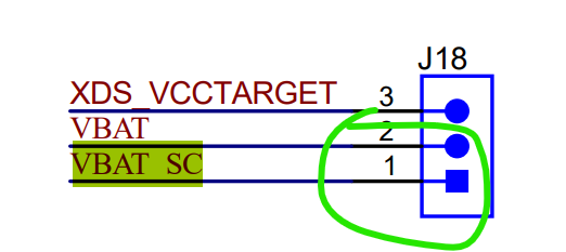

hi Expert,

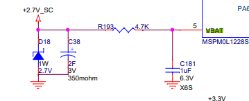

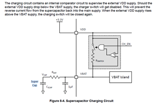

when customer uses function below to enable super charge,
DL_SYSCTL_enableSuperCapacitor()

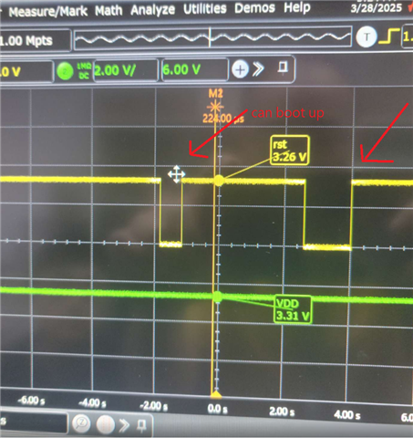

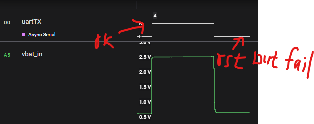

MCU can boot up and work well at first power up. if set reset pin to low, MCU cannot boot up. Already confirm that MCU is not in boot mode.
Green: VDD
Yellow: rst_n
if they remove function below, it can work no matter power cycle or reset mcu by set low reset pin.
miss anything?
