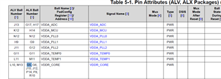

The device configuration under CCS Theia 20.1 does not corresponds to the information in the Datasheet, for instance in the datasheet there is a pin F5 (as well as in the launch pad PCB schematics and PCB files), and it is not available in the CCS, another clear example is the pin G5, documented as GPO6 in the sys config tool @ CCS, and as VDDR_CORE in the datasheet as well as in the launch pad PCB. As both launch pad and datasheet information correlates, it is what I'm using, however, I still don't know how to properly configure the pins under CCS and if I will be able to use them correctly. Please clarify.
