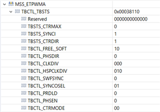

My customer want to synchronise ePWMA and ePWMB by performing SYNC OUT when ePWMA's TBCTR reaches 0 and ePWMB's count is set to 0 (same as ePWMA).
Use the following sample code
mcu_plus_sdk_am273x_09_02_00_52\examples\drivers\epwm\epwm_duty_cycle
SYNCOUT setting for ePWMA and PHSEN setting for ePWMB.
The ePWMA registers are as follows.
SYNCOSEL=0x01 and SYNC OUT is implemented when TBCTR is set to 0.
[Question]
For example, when I change the TBPHS of the ePWM to “1”, I feel that the TBCTR of the ePWMB is not set to “1” when the TBCTR of the ePWMA is set to 0. (as the output waveform does not change)
I would like to confirm that this setting is correct.
PHSEN is set to 1, but I feel that the SYNC OUT of the ePWMA is not recognised (I am concerned that the SYNCI bit is also 0).
There is no problem with the output waveform.
Check that the ePWMA and ePWMB continue to synchronise with this setting.

    There is no problem with the attached waveform, but they are not sure if it will stay synchronised all the time.
    What the customer wants to check is the correct register settings to synchronise ePWMA and ePWMB.
    If “1” is put in TBPHS, the TBCTR of ePWMB should be set to “1” when the TBCTR of ePWMA is set to “0”.
    However, the customer believes that the current setting is incorrect because the output waveform does not change.
    -In other words, they dared to change the settings to check if the settings are correct and tried to change the waveform, but failed.
    [Question]
    Please check if the register settings in the first attached image can be synchronised without problems.

  • Hi Ito,
    The ePWMB TBCTL_PHSEN value looks correct, but can you confirm if the values from the ePWMB screenshot are from before or after running epwm_duty_cycle example? And was epwm_duty_cycle example modified in anyway?
    I am asking because the code calls "EPWM_tbSyncDisable()" which will disable the synchronization. (Even if sync-in event occurs the count value will not be reloaded. Link at the end of post.)
    If ePWMB ran epwm_duty_cycle without any edits, this may explain the issue, but I still need time to check the other ePWMB items. I can give another update on 9 April.
    Haley
    ePWMB is the value after  running epwm_duty_cycle example.

    I finished reviewing the registers and code. Even though the registers values are correct for the usecase, I have four suggestions for code modifications which may help with the issue.
    These suggestions are based on epwm_duty_cycle, a similar use case in Controlling Multiple Buck Converters With Same Frequencies section from the TRM, and EPWM APIs (link to APIs at the end).
    • Set AQCTLA CAD and CBD bits to b'1 for CLEAR (also known as EPWM_AW_ACTION_LOW)
      • This is the main difference to check
    • Use EPWM_tbSyncEnable to ensure the TBPHS register is set with a value
      • Screenshots and code didn't show TBPHS registers for both epwms
    • Use more of the APIs and epwm_duty_cycle code
      • Example: Using EPWM_tbSetSyncOutMode(gEpwmBaseAddr_Pwm1, EPWM_TB_SYNC_OUT_EVT_SYNCIN); and EPWM_tbSetSyncOutMode(gEpwmBaseAddr_Pwm0, EPWM_TB_SYNC_OUT_EVT_CNT_EQ_ZERO);
    • One can also try modifying the usecase requirements to either utilize SWFSYNC bit to force synchronization pulse
    Link: https://dev.ti.com/tirex/content/mcu_plus_sdk_am273x_09_02_00_52/docs/api_guide_am273x/group__DRV__EPWM__MODULE.html#gaa19cd037728952934ce0e5b08ab55c4d

    Is the phenomenon correct that the TBCTR of ePWMB becomes “1” when the TBCTR of ePWMA is set to 0, even if TBPHS is changed to “1”?
    Ito
  • Hi Ito,
    If the TBPHS you are referring to is for ePWMB, then yes.
    This is because:
    • ePWMA is supposed to send the SYNC OUT signal  when the TBCTR is 0 for your usecase (quote below). Then, this SYNC OUT goes into ePWMB's EPWMxSYNCI
      • SYNC OUT when ePWMA's TBCTR reaches 0
    • Time-Base Counter Synchronization TRM's section description of "EPWMxSYNCI: Synchronization Input Pulse"
      • The value of the phase register is loaded into the counter register when an input synchronization pulse is
        detected (TBPHS → TBCTR). This operation occurs on the next valid time-base clock (TBCLK) edge.
    Overall, TBCTR becomes a "1" because TBPHS is a "1". Please note that I am assuming a valid clock edge and ignoring the screenshot of EPWMB_SYNCI = 0 in this answer. Let me know if I need to consider all previous posts or parts of previous posts for any future questions.
