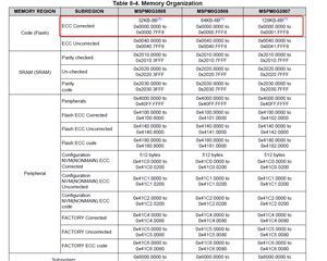

   I've seen that only one word operations are allowed for blank verify which is 64-bit(8bytes) what if we want to verify some odd number of bytes. And operations on odd number of bytes like read/write/Blank verify etc. Also how to get rid of ECC like only data operations I want to do without any ECC.

Where does the ECC go..?
Also Blankverification of odd number of bytes is it possible..?
