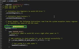

Good morning,
I've created an APP using TMS570LC4357 uC, once application is done I needed to create a bootloader, I've been able to jump from bootloader to app, but when doing so application ISR are not being called. In the other hand, if application runs on its own, without bootloader being present, interruptions work perfectly.
I have two linker scripts, one for bootloader and one for app, I think both of them are correctly declared, but this is my first time using a TI uC so I'm a bit lost about vector reset, if it needs to be changed somewhere else apart of linker script or if I'm missing some reason why interrupts aren't being called when bootloader plus application is running .

As you can see, application starts at 0x00020040, I have few doubts:
1) Bootloader vectors are defined at 0x00000000, once I jump to app are redefined at 0x00020040, using memory browser when debugging I can see that's correctly written into flash . Do I need to change vectors somewhere else a part of linker script?
2) I thought about interruptions not being enabled, but in my code, there is an initialization where interruptions are being enabled:
     - sciEnableNotification(...)
     - rtiEnableNotification(...)
     - _enable_IRQ()
I don't know what I'm missing, but it seems to be related to me adding bootloader, any idea on what can be the reason for ISR not working?
