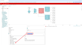

The tool is detecting an invalid error, explaning the range of the acceptable data is [1;63] and refusing the value "5"
The value 5 is used in EVM board, so I am sure that it is a valid configuration
I propose you a correction of the json file used for the description in the tool
Please update the tool in a new version, based on this change, as the generation of files is blocked when an error is detected
On my setup, the file modified is "C:\ti\sysconfig_1.22.0\dist\deviceData\AM64x\clocktree.json"
...I will include the file in next message, as blocking the creation of the ticket for now...

  • Perier,
    Yes.  It looks like it was hard coded to only accept 1 as a choice.
    I will update to use 1-63 as acceptable values for the next release.
    Adrian.
