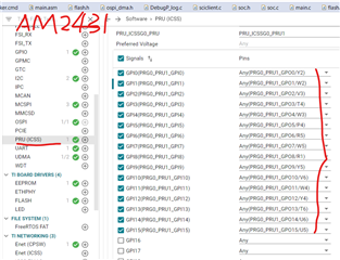

I am working on code portage from AM2431 to AM2612. CPU is the only changed part and other peripherals are kept unchanged.
When I use PRU0_GPIOx linked with GPIOx to detect ADC output, I can't get expected result. ADC channel outputs are fixed status without affected by ADC input.
The same PRU code is working on AM2431. Compare the difference,  PRU_GPIx mux configuration is changed from PRU_GPOx to GPIOx.
On AM2431, PRU code is simple to read R31 register and get the ADC result. But on AM2612, I guess GPIO initialization on PRU or R5F is mandatory to be done.
I looked up in AM2612 SDK and document, there is no example about this. Could you please supply an example?
