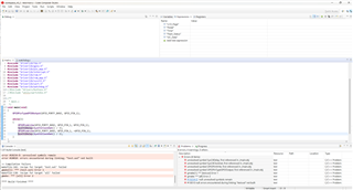

I have read all the documents on TI's website but there's a problem in the new project.
I imported the example project is ok and could debug or download to the chip.
But it can not worked if I created a new project, even the codes are the same as the example.

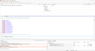

The error code is #1965, and sometimes #10234-D and #10010 if I coding with new code.
Are there any configurations that I need to check?

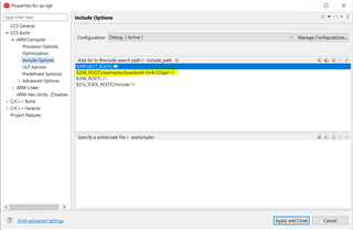

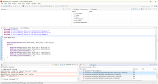

    Based on your above errors, the compiler is unable to find drivers/buttons.h The buttons.h file is at C:\ti\TivaWare_C_Series-2.2.0.295\examples\boards\ek-tm4c123gxl\drivers. Therefore, you need to have the include paths that can searched by the compiler to find the source files. See below. This is why I suggest to base off an existing working example and then copy that project as a starting point for your new project. You can start with the example like C:\ti\org_TivaWare_C_Series-2.2.0.295\examples\boards\ek-tm4c123gxl\qs-rgb or C:\ti\org_TivaWare_C_Series-2.2.0.295\examples\boards\ek-tm4c123gxl\hello or even the simplest one like C:\ti\org_TivaWare_C_Series-2.2.0.295\examples\boards\ek-tm4c123gxl\blinky.
    If you are using buttons.c file, you need to make sure that file is linked to your project. See below that is already done for the qs-rgb example so if you base off this example, you will not have any compile issues.
