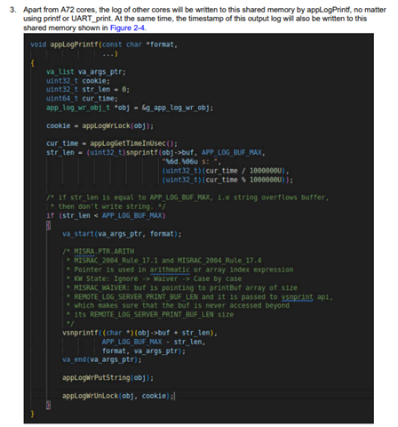

1: No Lock & Unlock / Resource Mutual Exclusion Mechanism
Like for the application note in Jacinto devices, the theory is the same, other cores writing log to the share memory, and A core read the log out and print. We could see the Lock protection in the coding below.
https://www.ti.com/lit/pdf/spradg5
The appLogWrLock is the function used before other cores writing to the shared memory.

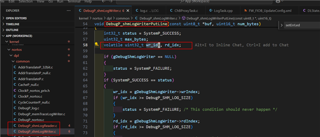

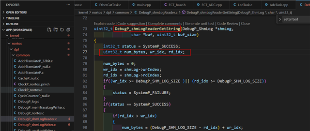

2: Volatile Missing in DebugP_shmLogReaderGetString
We could see that in DebugP_shmLogWriterPutLine, the wr_idx, rd_idx have the protection using volatile shown below.
However, in the DebugP_shmLogReaderGetStringthe wr_idx, rd_idx do not have the protection volatile anymore shown below.
We are afraid that the Reader function may read an outdated wr_idx, leading to miscalculation of the buffer's remaining space and consequently skipping newly written logs . Similarly, after the Writer updates wr_idx, the Reader might fail to perceive the latest value, resulting in unread logs.
