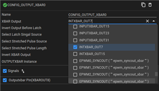

    I set the above configuration for OUTPUTXBAR, selecting the required Adc event (You may select any OUTPUTXBAR here)

  • I fear that there is a missing step here somewhere.  Currently, I have RTI1 generating an interrupt at 32Khz. The RTI1 interrupt was as working properly by creating an ISR function that toggles a hardware output.  The RTI1 interrupt is then used by ADC0 Burst mode to start a 6 SOC burst. ADC0 has an interrupt configuration for ADC Interrupt 1 set to the end of conversion for SOC/EOC15.  This interrupt was verified as functioning correctly by creating a test ISR that toggles a hardware output.  At this point in the operation, it has been validated that ADC0 Interrupt 1 is working as expected.
    I have the Output XBAR configured to use "ADC0_EVT1" using OUTPUTXBAR8. SysConfig appears to generate code for this, and I have not modified or added additional code for this configuration. I am using the default pins (C8) for this and monitoring it with an oscilloscope. No matter how I configure the Output XBAR configuration, no change in signal level is seen during runtime. I can change the logic high/low level seen at runtime by changing the Invert XBAR Output setting. I have tried every combination of settings in the Output XBAR configuration, but still cannot see any change in the status of the output after initialization.

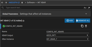

    1. OUTPUTXBAR has two inputs connected to INTXBAR.
    2. Select one of these as what OUTPUTXBAR will output.
    3. Map your ADCx_INTy to the same INT_XBAR
    4. Configure ICSS to use the same outputxbar for INTC.
    5. Register the interrupt in code(You can refer the same adc_soc_rti example for this)
    After this I ran the program, and got following outputs verifying my expectations:
    1. Interrupt output on scoping OUTPUTXBAR8
    2. Value change at
    Please let me know if it helps!
    Akshit

    This is just routing the signal to PRU's Interrupt Controller.
    You don't need to register this interrupt in R5, and you should still be able to get correct results.
    The simple goal for this functionality is to have the PRU handle all functionality associated with the ADC end of conversion. The R5 core can do the setup and initialization of any XBAR or ICSS instances needed, but the implementation should not require intervention of the R5 when the ADC end of conversion occurs. I had hoped that the XBAR could help accomplish this.
    This is exactly what is happening in this scenario.
