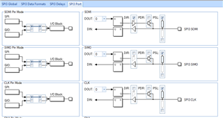

I’m working with two LaunchPad development boards using the TMS570LS1224 microcontroller. One board is configured as the SPI master, and the other as the SPI slave.
I need to use SPI receive interrupts on both master and slave sides when a data byte is received via SPI. Both boards are connected using SPI3.
On the master board, the interrupt works correctly when I use the function:
spiEnableLoopback(spiREG3, Digital_Lbk);
In this case, the interrupt triggers properly, and the LED connected to PORTB GIO pin 2 turns on as expected.
However, when I apply the necessary configuration for the slave to work with receive interrupts (instead of loopback), the interrupt does not trigger on the slave when the master sends data.
Note: I have ruled out wiring issues, since the slave does receive the data correctly using polling mode. The issue seems to be specific to using interrupts on the slave side.
Can you please help me figure out why the SPI RX interrupt doesn't work on the slave when connected to the master, even though it works in loopback mode?
I’ve attached the CCS code and HALCoGen settings for the master and slave below.
Master Code CSS

Halcogen Master
Code for Slave

Halcogen Slave

  • Hi Jagadish,
    I would like to thank you for your example project—it was extremely helpful as a reference and guide to resolve my issue. Based on your code and explanation, I was able to successfully implement SPI communication using interrupts between two TMS570LS12x LaunchPads.
    Below, I’m sharing the solution I used in case it helps someone else working on a similar setup.
    Working SPI Communication Between Two  LaunchPads  TMS570LS12xx (SPI3 Master & SPI1 Slave) Using Interrupts
    Setup:
    • Board 1: Uses SPI3 as Master.
    • Board 2: Uses SPI1 as Slave.
    • SPI data is sent from Master after receiving a command via SCI from an HMI.
    • The communication worked in polling mode, but switching to interrupt-based SPI required a few important adjustments.
    Changes in HALCoGen Configuration (Master Side - SPI3)
    To make the SPI Master (Board 1) compatible with the SPI Slave working in interrupt mode:
    1. SPI3 → Data Format 0 → WDELAY = 3
      • This sets a delay after asserting chip select, giving the slave time to get ready.
      • Essential for synchronization when the slave uses interrupt-based reception.
    Changes in Code (Slave Side - SPI1)
    In the interrupt-based implementation, the following was crucial
    2  In main() (Slave - SPI1)
    Call spiGetData() before transmission begins:
    spiGetData(spiREG1, &dataconfig1_t, 1, Rx_SPI);
    This initializes the receive buffer and allows the slave to respond when the master starts clocking
    3 In the interrupt handler spiEndNotification()
    Add the same spiGetData() call inside the handler to re-arm the reception:
    void spiEndNotification(spiBASE_t *spi)
    if (Rx_SPI[0] == 125)
    gioSetBit(gioPORTB, 1, 1);
    else
    gioSetBit(gioPORTB, 1, 0);
    Outcome
    With these changes:
    • The slave correctly receives SPI data sent by the master.
    • The communication is reliable and interrupt-driven.
    • The gioSetBit() toggles allow easy debugging via LEDs.
